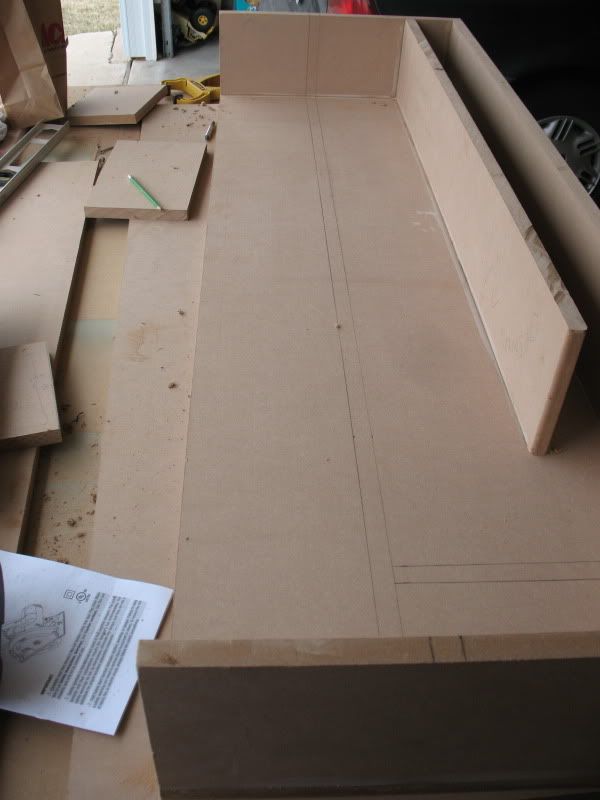

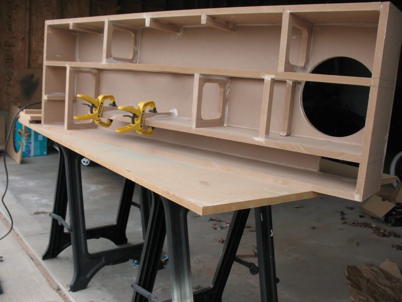

Here is another build project I have been working on. This one is for a customer of mine. They have children and did not want a sub (or speakers) anywhere within the kid's reach.
I will be doing 5 in-ceiling speakers, 3 with directed sound-field options for the front.

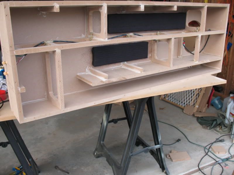

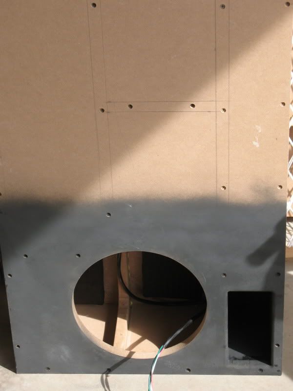

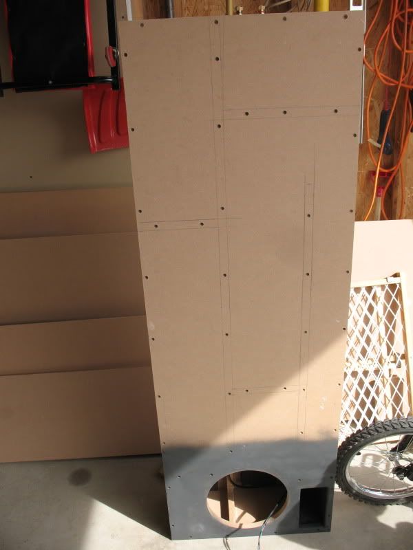

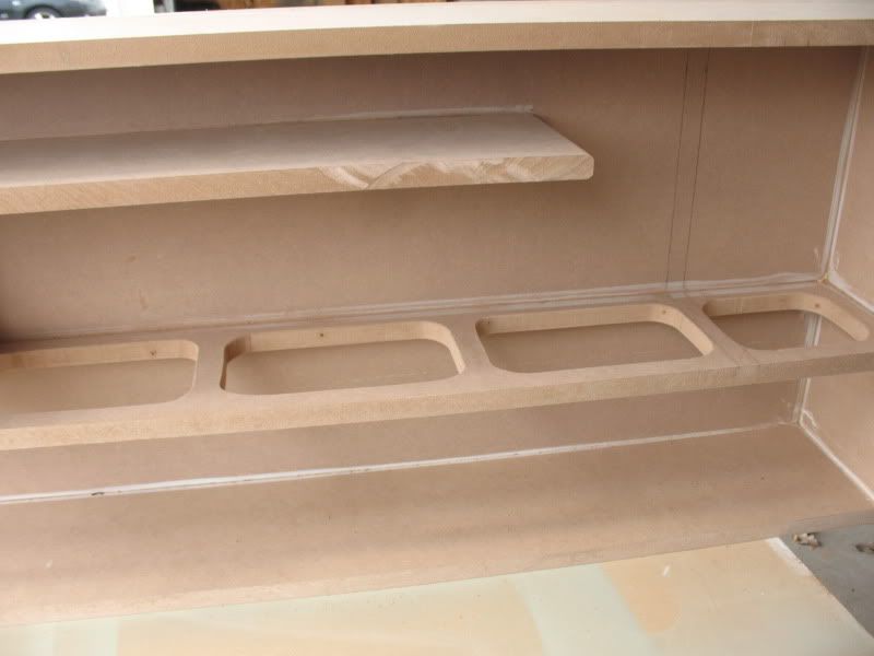

The enclosure is tuned to 20hz and allows a vent velocity of just 14m/s with 300 watts of input power (will be powered with the BASH 300). I used a combination of ribs with window bracing this time through.

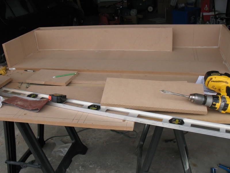

Here is my build progress so far. More pics to follow as the project moves along. I am waiting for the sub to arrive currently.

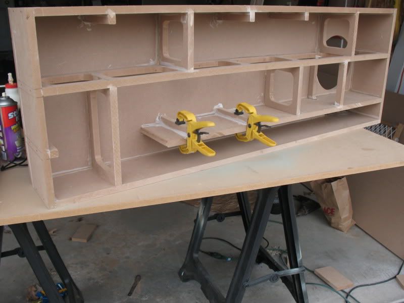

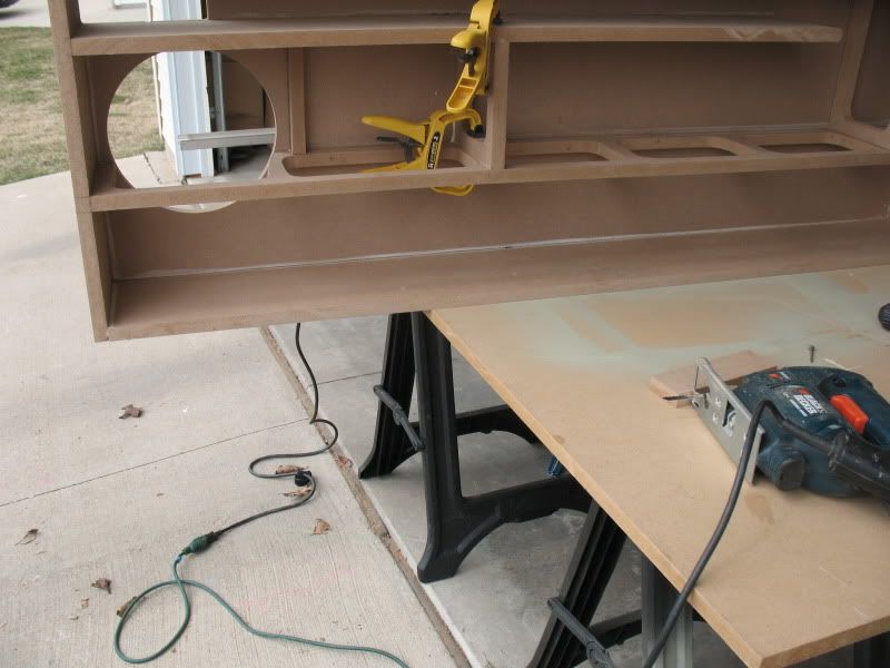

Gluing up some final ribs:

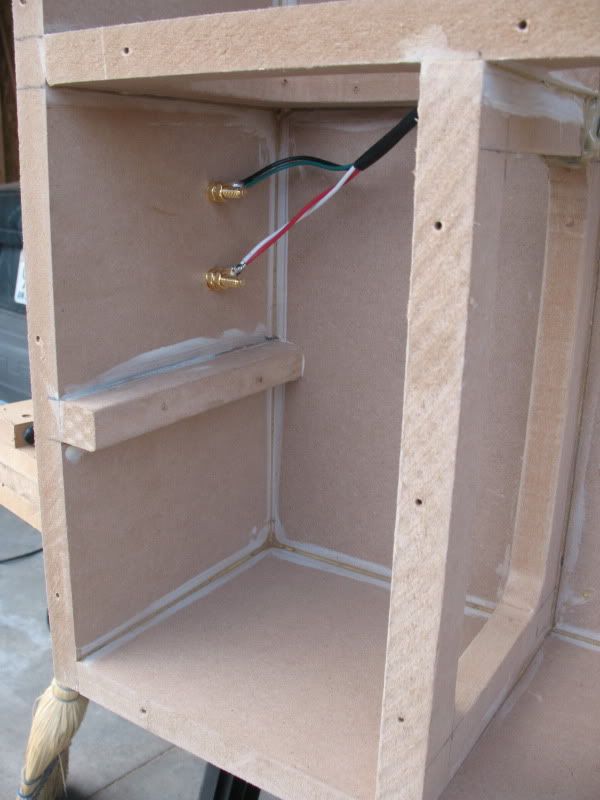

Binding posts added:
Internal shot of binding posts:

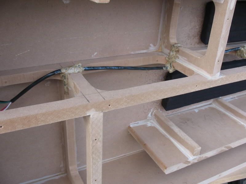

Since this will be in a ceiling, and internal enclosure rattles cannot be tolerated, the internal wiring is zip tied to the bracing and then held in place with a generous amount of PL adhesive:

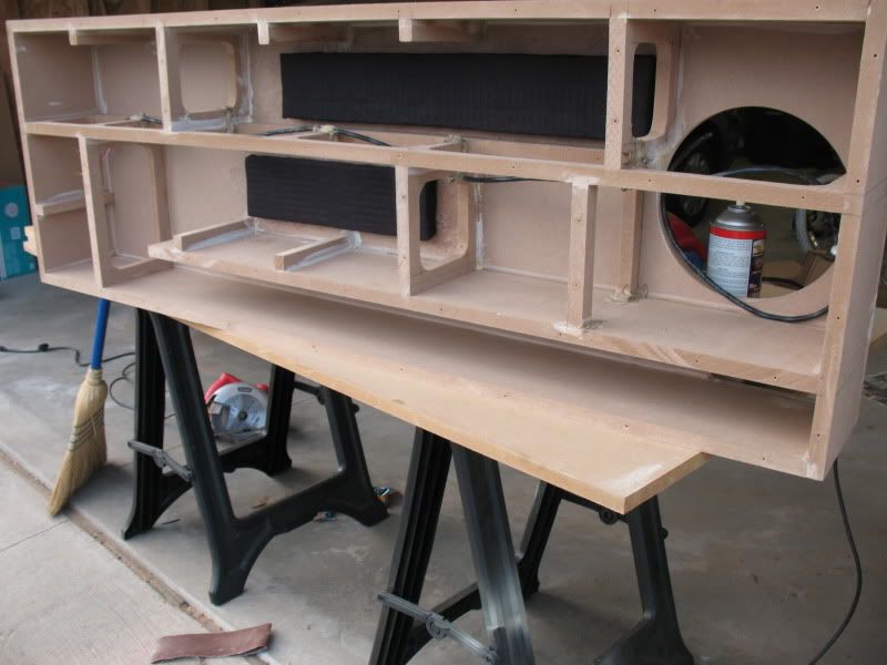

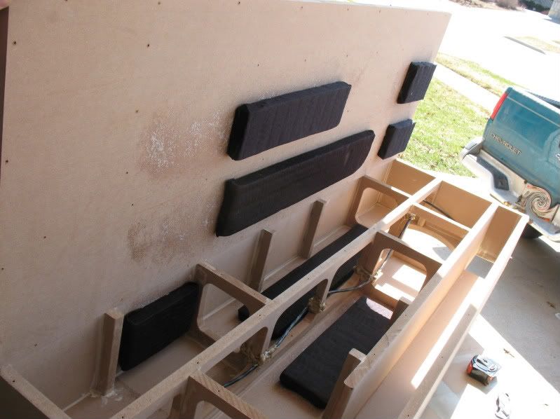

Internal shot, with some rockwool added:

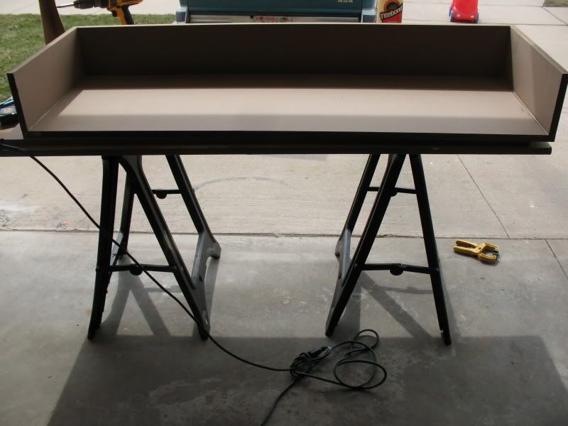

Bottom ready to be attached with additional rockwool attached:
Finished!

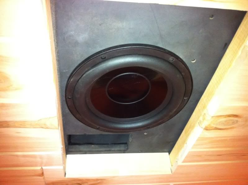

I did finally finish this project (finally) after the homeowner decided to get it completed a year later. I have custom grille design for it as well but the homeowner opted not to do a grille :)confused:)
Here is a pic of the sub in it's final place in the ceiling:
