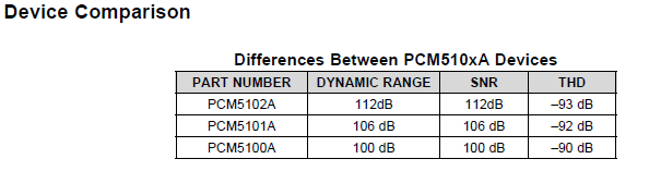

Since you already have the A-S501, I won't tell you not to try but I would stick with facts, that is:
A-S501 has a very mediocre DAC IC, with specs well below the typical <$100 (or even less) dongle type ext. DACs
It has the PCM5101 IC, the important specs of that IC such as distortion and noise (SINAD) and SNR/DR are, from the data sheet:
PCM510xA 2.1 VRMS, 112/106/100 dB Audio Stereo DAC with PLL and 32-bit, 384 kHz PCM Interface datasheet (Rev. C) (ti.com)
The Chromecast audio reportedly has the AK4430 IC and have been confirmed in a teardown:
Archimago's Musings: MEASUREMENTS: Google Chromecast Audio - Part I: Analogue Output
Archimago's Musings: MEASUREMENTS: Google Chromecast Audio - Part II: Digital Output
The first link has a link to the teardown if you want to see it.
Otherwise take a look of the AK4430's specs:
AK4430 pdf, AK4430 description, AK4430 datasheets, AK4430 view ::: ALLDATASHEET :::
You can see that the two are virtually equal in THD+N and DR so in theory there is nothing to gain to go through the trouble of some extra connections. I would just use the analog output with the A-S501and enjoy..

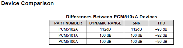

Thanks a lot PENG for such a mountain of valuable information! so pretty much just stick with what I have and keep using the Chromecast Audio DAC.
