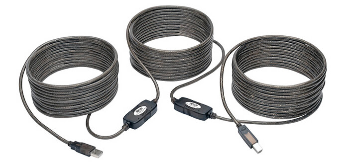

Get a USB repeater with low lag, because with any active connection, you're going to introduce lag.
These people claim no lag.
Not saying the above is the best device choice, but as a category, this may be a solution. I was going to wire this under the floor, and behind the couch, but I ended up just getting the corsair lapboard and the 502, and the problem went away.

And a USB hub like TLS said. I use this one. It used to be $15 bucks not that long ago.
Or
