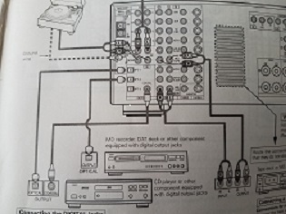

Thanks, again lovinthehd! I had noticed the 3 optical inputs that you point out BUT in another schematic in the manual (pg 7 ) they are shown as "Optical Outputs" (photo attached). I had assumed that I could not go from an Optical OUT on the back of the Vizio TV to an Optical Out on the back of the Denon. Is that assumption wrong? I do not see an Optical IN anywhere on the Denon. In the meantime, I have ordered a 9 ft Optical cable from Amazon...arriving Friday.
Thanks, again lovinthehd! I had noticed the 3 optical inputs that you point out BUT in another schematic in the manual (pg 7 ) they are shown as "Optical Outputs" (photo attached). I had assumed that I could not go from an Optical OUT on the back of the Vizio TV to an Optical Out on the back of the Denon. Is that assumption wrong? I do not see an Optical IN anywhere on the Denon. In the meantime, I have ordered a 9 ft Optical cable from Amazon...arriving Friday.View attachment 22976
An easier way to view is downloading a pdf of the manual, you can do it free from here (maybe even still the Denon site, this came up first) https://www.manualslib.com/manual/38363/Denon-Avr-3300.html
The outlined box surrounded the 3 optical and one digital coax ports are labeled "in" on the diagram on page 7 and page 7 connection diagram refers to connecting the optical audio outs of other gear, in their examples MD and CD players, to the optical audio ins in that lower left corner of the avr.
Once you get your optical cable then connect the optical out on the tv to the optical in on the avr, it appears using optical 3 is the default for the tv/dbs input per page 25 of the manual (or you can use the instructions for assignment).
You're getting there....altho it still may not give you 5.1 audio via the optical from hdmi inputs to the tv.
