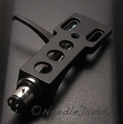

Can you post some pics of your technics turntable? Just to see it. Curious. I had a bootleg version of that table by a no name. Are you in the US? My Headshell was like the original though. Well what do you know here it is on ebay:
Link if interested:

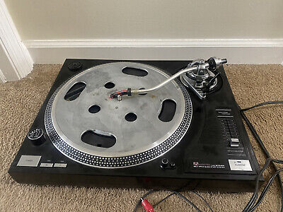

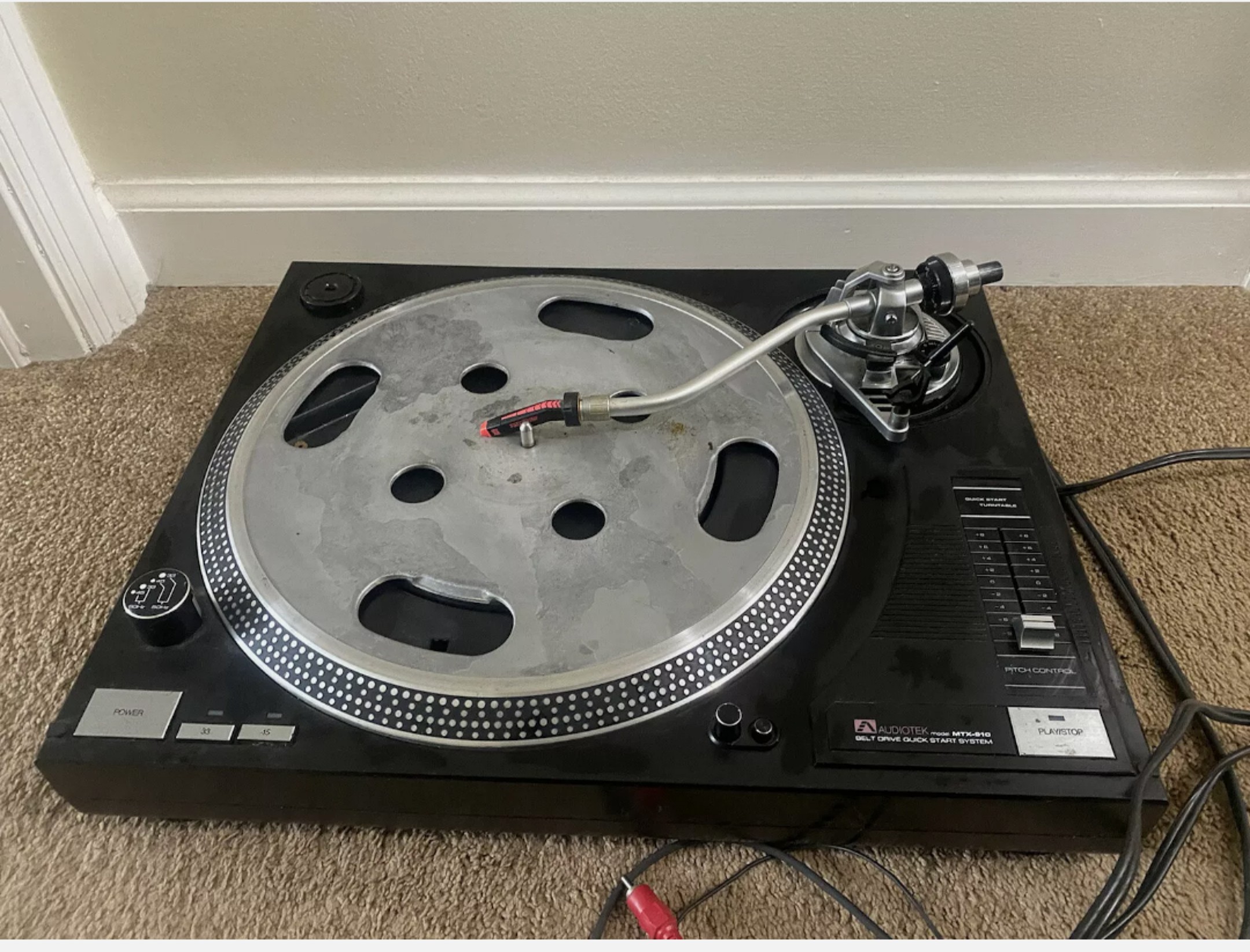

yea ill include a few pics here:
I have my AT mat on as the original mat is in rough shape
the platter is only removable with screws and is solid metal with 2 circle cutouts near the outside of the platter completely opposite.
I live in Minnesota but if you have the headshell and are willing to sell it lemme know :)
Table looks great. Just use a pillow case as a cover, so no extra dust gets in. till you find a cover for it.
I don't have that TT anymore it drowned in the sandy storm in 2012. It was a decent table too. Looks like you only need the Mat and Headshell.

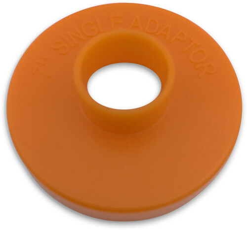

These should work:
45 adapter
