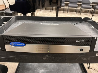

You cannot connect your Sony to an external amplifier to power the speakers at all. So, you can't just 'get more volume'. You need a way to connect a amplifier to your receiver to get volume control properly. Otherwise, you can buy an amp with a lot of power, but sources would need to be connected directly to that amp and you just toss the Sony to the side since it doesn't support an external amplifier at all.
An amp like this will give you a ton more power to work with, but without a preamp to go along with it, then you are doing a lot of wiring anytime you want to use it...
