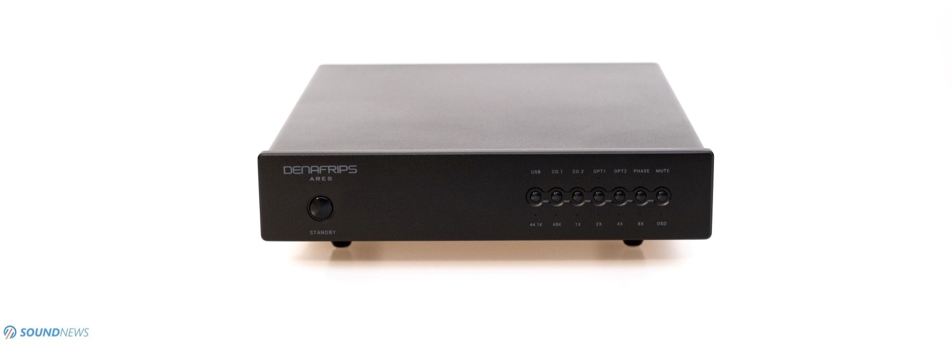

Not to argue. But the Denon is not on the same planet as the Denafrips Ares II. Just is not. After some similar connection concerns, I HEARD the difference. Quite a large difference. HOWEVER...
