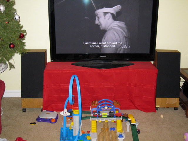

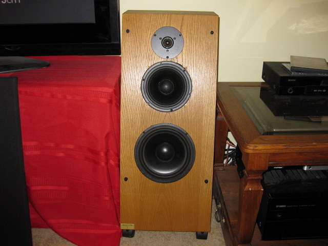

I just got all of the speakers and finally installed them. when i picked up the cabinets i was under the impression that they only needed the mids but when i picked them up I found that they needed the tweeters as well. The mids were Focal but they are no longer available so I was sent two SEAS Prestige CA18RNX (H1215) mids but the holes in the cabinet are a little on the big side and I needed to center the speakers in the holes dead on and use the goo speaker gasket sealer to assure a tight seal. I received the tweeters next and again the Dynaudio D28 are not available either, so i was sent a pair of Dynavox TD2801XL and they were pretty much a direct fit. Once everything was together I hooked them up to my Yamaha RX-V3000 receiver and I wanted my first impression to be unequalized so i put it to processor direct and listened and they sounded great!!! I think they might be a little power hungry or it's just that there is no background noise adding fill (clean almost sounds quite) But after a very short listening time (getting late and had to put the kids to bed) I can say I was pleased with the overall sound if they sounded a little light in any area it was the low bass area but again I have been adding bass through my receiver with my old speakers, I can say that the bass is tighter and more responsive. I will take pics and post them by tomorrow hopefully and have time to listen to them some more. I need to listen to some Peter Gabriel before drawing any conclusions .
