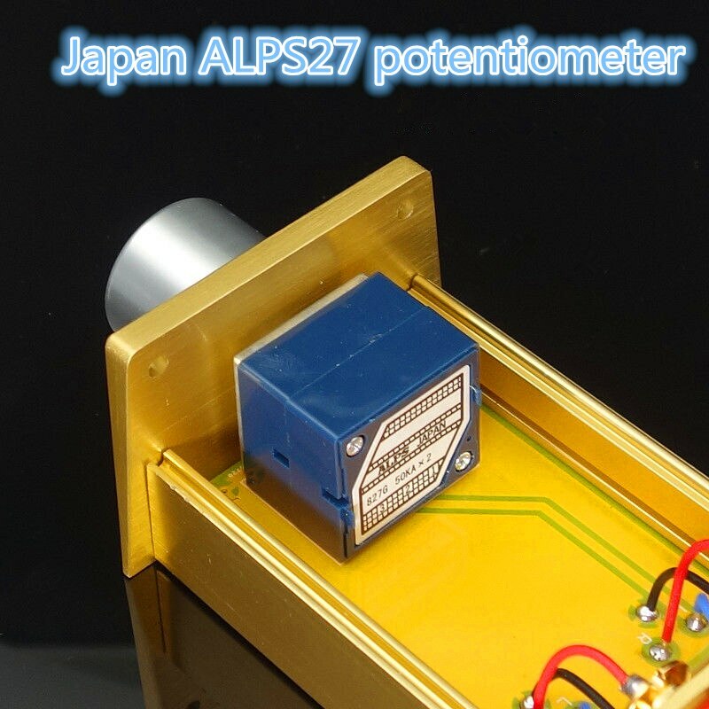

You can clearly see that unit is just a volume control.
So, unless the output from your phono preamp, which has to be active, is too "hot" for the input of your Cambridge amp, it is superfluous and harmful.
