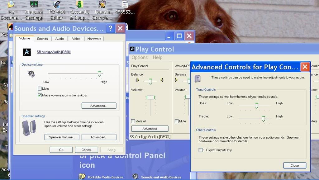

i have to tell my soundcard to output digital in the software, otherwise its analog.

which sound card? Mine is under sound devices, advance panel, the advanced again

2 Problems:
1.) "Sound and Audio Devices" Device volume is at "low" and I can't adjust or click anything there. As I see you can adjust and click on yours.
2.) I have the "Play control" but I don't have that advance option that leads to "Advance control" to click on "Digital output".
Starts to look like I need a new sound card? I wonder, what's a good sound card to buy at this time? Thanks for the information.

Check to make sure that SB is the default playback under hardware
