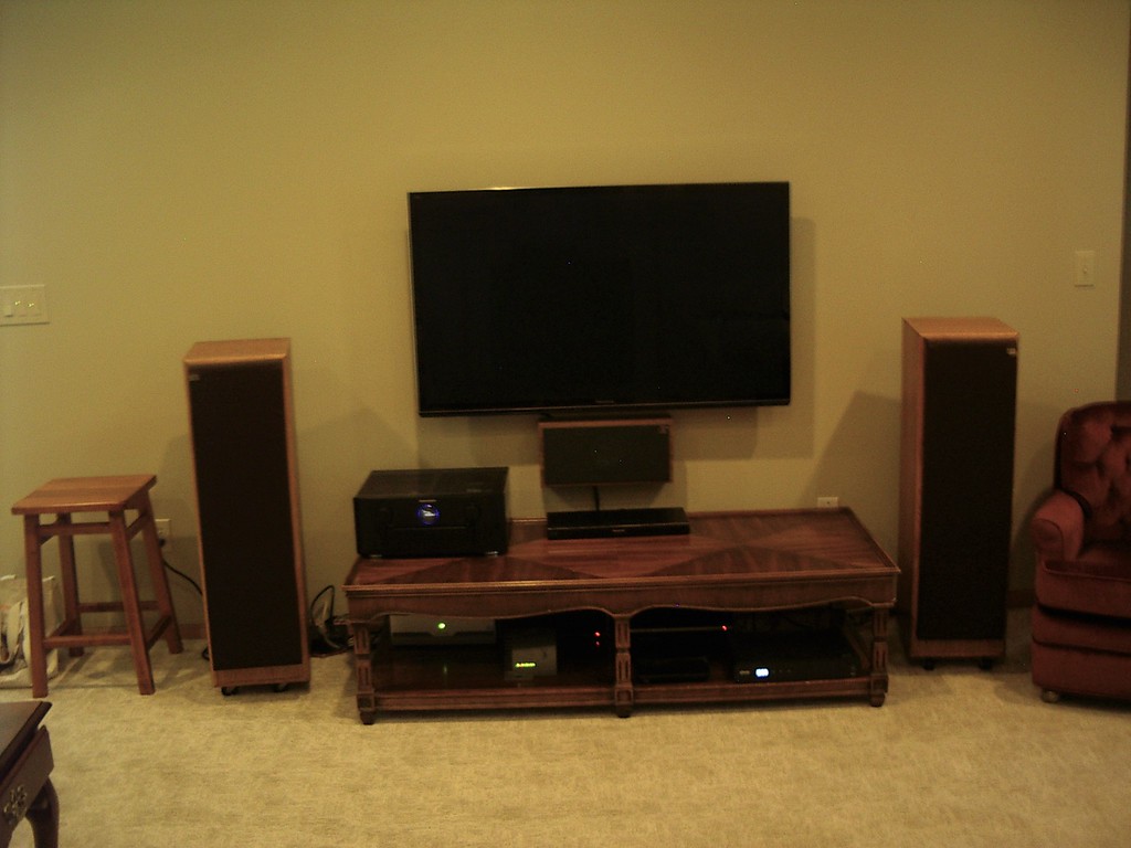

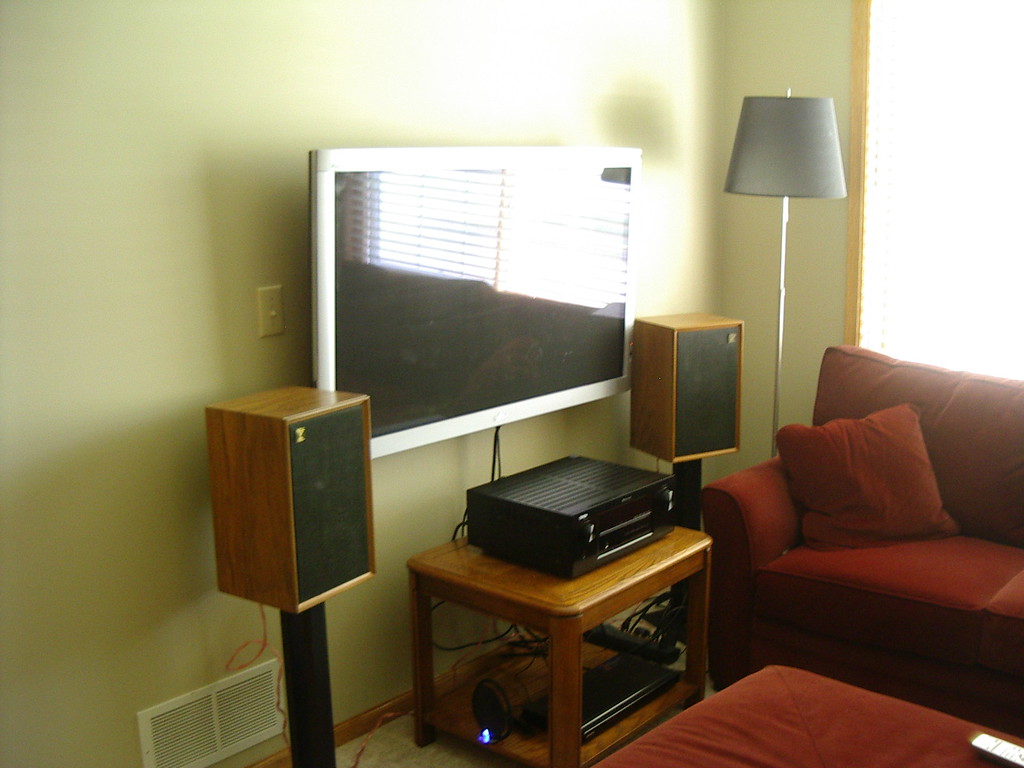

As the tittle says I have bought a receiver! It is a Denon AVR-2313CI.
I bought it used on eBay for $175.00. I assume it is 2012/13 vintage. It is for a small bedroom which we now use as a small sitting room, and kids play room in our Quad 4 Eagan condo town home. The grandchildren have asked for a room for gaming. As you can see it is a very small room.
The screen is the 2005 Fujitsu Plasma that was the original screen in the studio at Benedict. That screen gives a marvelous picture and is just a screen.
The unit has FM radio, a Chromecaster, and a Sony DVD player that we discovered in the unpack after the remodel. I had forgotten we had it!
The speakers are full rangers, using the 4" Jordan Watts Modular speaker. I listened to the Mozart Grand Partita on Sunday night on the BPO Digital Concert Hall. This work is for a wind ensemble and a double bass. It is a great favorite of mine. These little speakers have astonishing bass. The bassoons, bass clarinets and string bass were reproduced faithfully along with everything else.
So we now have a couple of systems there as well so my wife and I can watch or listen to something different.
I will need to get a more potent speaker system before the grand children game, that will be a future project. The sub will need to be very small.
This is the main system there.

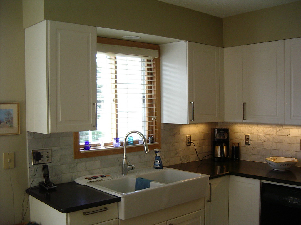

Now we had a bigger problem.
Because of the window location and width of the kitchen, we had a problem on this corner, with the need for a small spacer on the left and a much larger one on the right.
When we cut and installed spacer panels it looked awful.

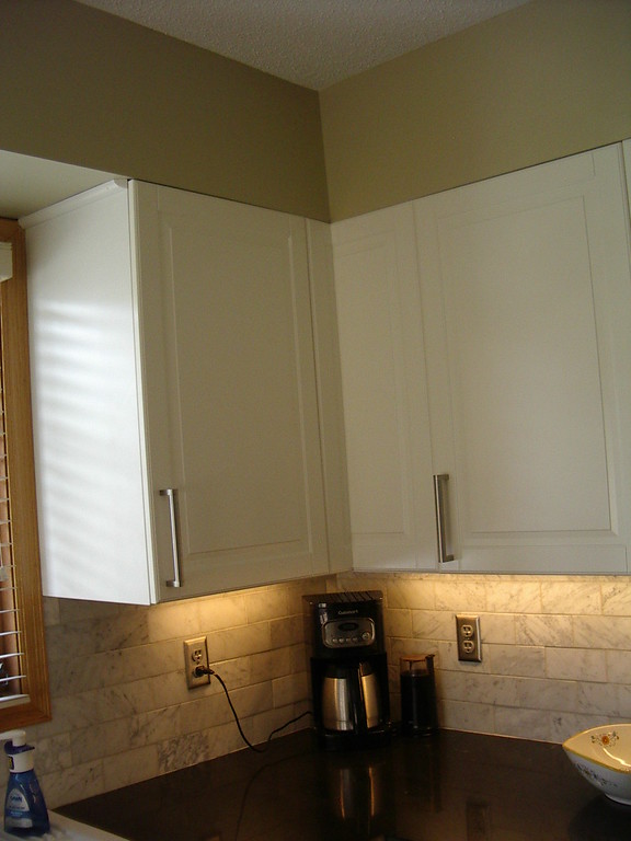

So I had to go and purchase a couple of doors we could cut down and construct a miter joint.

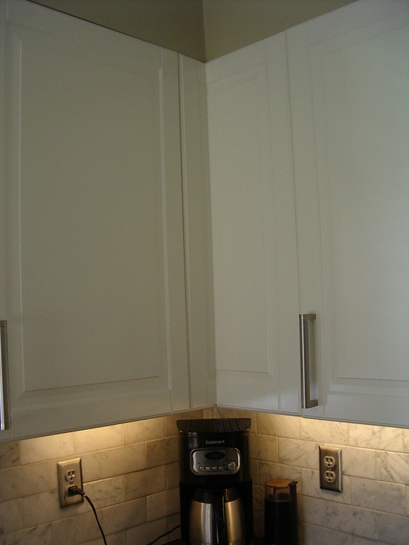

Even under the best of circumstances there will be tiny gaps on the edge. With a lot of difficulty I managed to find some coper's white filler and worked it down the seam.
Now the lack of Ikea touch up paint was a problem. Apparently the Ikea paints are hard to match. I found out after an Internet search that Home Depot have the closest match. When I went to home depot they were familiar with the issue. Their paint is a good match, but the gloss is different. However after putting masking tape either side of the seam and painting it with a fine hair brush it looked pretty good. Enough to keep my wife from complaining anyway.
This is a close up.

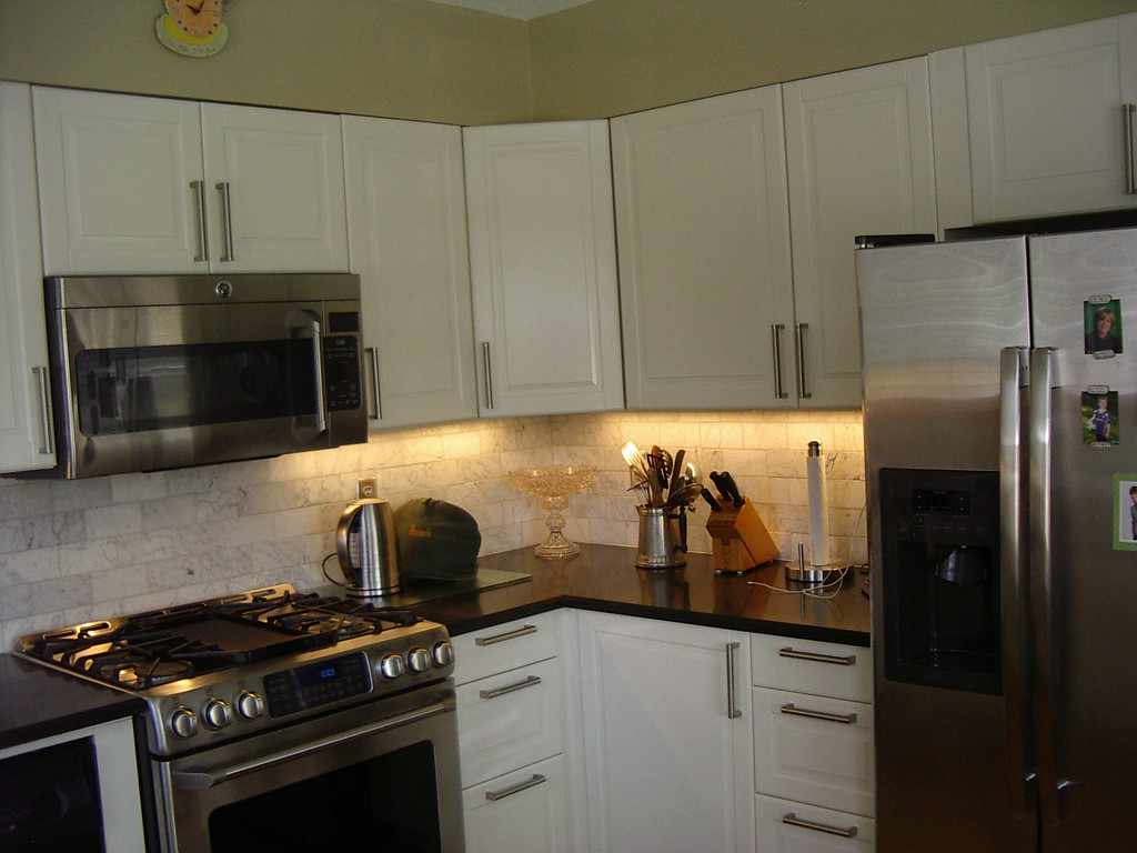

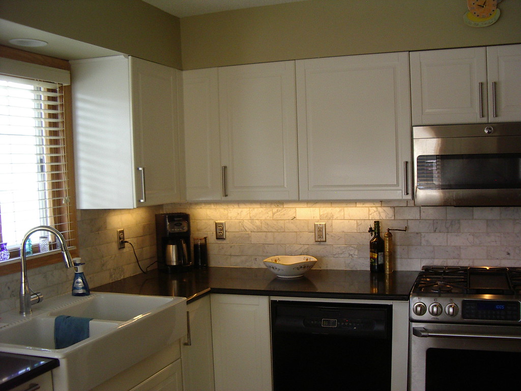

In the end though, the kitchen is very functional. We have entertained there and I can cook complex meals without a problem. It is a big improvement over the old kitchen.
So these Ikea kitchens are not perfect and there are definite areas where Ikea have room for improvement.
I think the value for money is pretty good. The total cost of the Ikea part of the kitchen was $6,800 near enough. That is significantly less than a custom kitchen, but you have to work hard and use some ingenuity for the savings.
