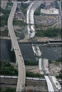

I-35W highway bridge over the Mississippi River in Minneapolis collapsed.

My god I thought this was just located in one spot! It’s like some 800 or 900 yards of the bridge is, is, and just buckled away as if a ferry hit it dead on!:(
