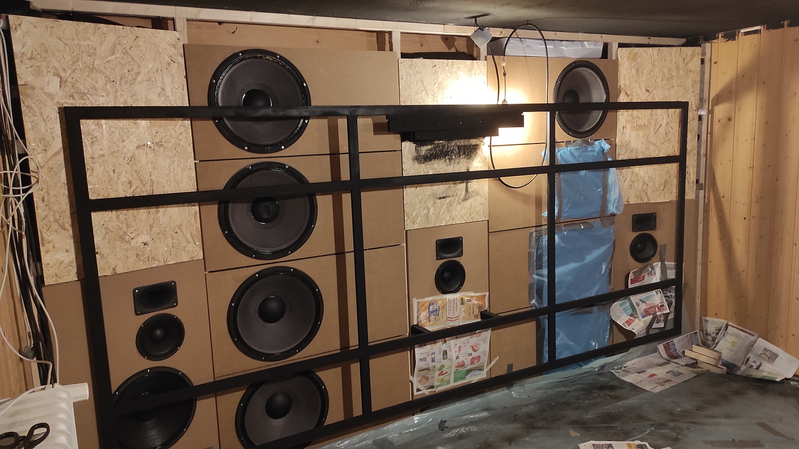

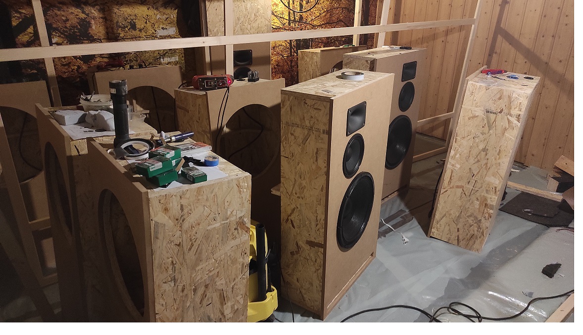

Hi guys,
just found this thread and like to bring in one view as I just start experimenting with different sub crossover frequencies.
I run a big Single Bass Array as Subwoofer solution to get as much as possible rid of the room modes and get a even distribution.
So I am questioning the 80 Hz crossover in this case for 2 main reasons:
1. The array will for sure bring better results in base frequency as the main speakers. So I see a clear benefit in increasing the crossover frequency as high as possible / as high as the array properly works and crossover to the rest of speakers still works good. Depending on the distance and wavelength maybe up to a octave higher at 160 Hz
2. Avoid crossover in kickbase area. 80 Hz is more or less middle of kickbase area, so might be better NOT to crossover here and leave the playback to the subwoofer alone. So either crossover much lower or higher.
Have not yet finished my experiments as also acoustical treatment of my Theatre is not yet finished but will keep going on in this direction and also share my results with you
Greetings from good old Germany

The problem is, above 80 hz is where we can start localizing the source and quite a few of us co-locate multiple subs for a more even response through the room. Aside from that tho, yes a higher crossover may indeed be beneficial depending on sub placement, your main speakers and room acoustics. There's lot of "it depends" in there tho.
*Edit: your bass array sounds interesting. Got any pics?
I've used crossovers of 120 well enough (with multiple subs, with a single I can localize too well). To really see what's going on you should get a measurement mic and something like RoomEQWizard software, tho if it sounds good to you at 160....
ps Nice work on the speakers!
