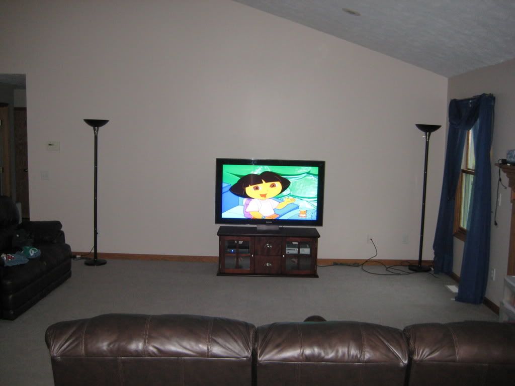

I too am in almost the identical situation as bkbond12. I am buying a Panasonic Viera 46" plasma THPZ46800U and planning to hook it up with the PS3. I have decided on getting the Denon AVR3808CI receiver. I can spend an additional $3K to $3.5K on speakers.
However my living room is not that big, but extends into the dining area as well. Here are answers to some of the questions FirstReflection listed:
3a) L*W*H = 13*12*10 feet
3b) It opens into the dining area which is slightly larger than above. Basically, if I am sitting on my couch and watching the TV, the opening is behind me.
3c) Head to TV would be about 9 feet.
3d) Do not want wall mounts. Prefer floorstanding or stands.
3e) Definitely would like accuracy. My listening preference is about 70% music/30% TV-movies.
I mostly listen to stuff like Radiohead, Pinback, RHCP, Dido, Ben Harper. Not sure how to describe it, but I like good full sound that surrounds me. I heard Totem Acoustic speakers (Totem Mite) and they seemed decent. However, not sure if there are other options that you can suggest I check out. Would really appreciate your advice!

raptorzfan,
great choices all around so far on your TV and receiver.
Your room itself is small, but with an opening to another room at the back, the total size of the open area is larger. Still, even with the dining area included, it's a medium sized room, so there's no real worries with any decent speakers as to whether they will be able to play loud enough or be driven by your AVR-3808CI.
My personal opinion is that you would actually be best served by using a 5.1 speaker setup. Furthermore, I would recommend using monopole surround speakers rather than diffuse di-pole or bi-pole surrounds. My reasoning for this is two fold:
1) You've said that the majority of your listening is music. While good di-pole or bi-pole surrounds can still sound just fine with music, in general, monopole surrounds will give you a better experience with surround music or when expanding stereo music to 5.1 using Dolby Pro Logic II.
2) With a large amount of room behind you, using diffuse surround speakers would lead to a significantly "fuzzy" sound behind and around you as the sound would reflect off the back wall and reach your ears at a significant delay.
Adding surround back speakers (a 7.1 setup) could resolve some of this, but then you would also have speakers positioned in your dining room, and I'm not sure if that is something you'd want.
In the end, sticking to a 5.1 setup with monopole surrounds just makes more sense to me. You'll want to place the monopole surrounds slightly behind your listening position rather than directly to either side. Basically, get them about 2 feet behind your seat. Have them fire across the room directly at one another - do not aim them towards your head. And if at all possible, have them positioned above your seated height - as in, try to get the tweeters about 2 feet above your seated ear height. For most people, that'll mean having the tweeters about 5 feet or so off the ground.
With a smaller room width, it'll also be good to avoid really wide dispersion from your speakers. It's better to limit the amount of reflected sound from your front speakers and have more direct sound hitting your ears.
That consideration, along with the other things you've said about prefering floorstanding or stand mount speakers with a "full" and encompassing sound leads me to highly recommend the av123.com Rockets to you as a great choice.
The ring radiator tweeter is about as flat and accurate in frequency response as you can hope for. Its dispersion is a bit more narrow though - some detractors of the design even say that it "beams". But in your situation, with a room that is not very wide and thus a more narrow seating area, this is actually a benefit and it will allow for extremely clear and detailed sound from your music.
The Rockets also possess a very nice warm and full sound and from what you've described, I think you'd be thrilled with their sound quality.
They are gorgeous speakers in terms of looks. While they are certainly not small, they enhance any room with their looks, rather than being something you would want to hide. The gloss black end caps will also match perfectly with the slick looks of your TH-46PZ800U.
I'll leave the exact choice of models up to you and I'd certainly recommend that you call or write to av123.com to discuss exactly which models would work best for you. Their customer service is excellent and I highly recommend talking with them prior to purchase because it is a most pleasant and helpful experience.

Thanks a ton for your advice! Monopoles definitely make sense based what you have shared. I will also give av123 a call and discuss. Although like a lot of buyers it does not naturally come to me to buy speakers without listening. I am hoping talking to them would help. I will also be checking out PSB, Mordaunt-Short, Aperion (online), Monitor, Totem Acoustic, and Paradigm speakers as well this week. Will let you know what I ultimately buy.

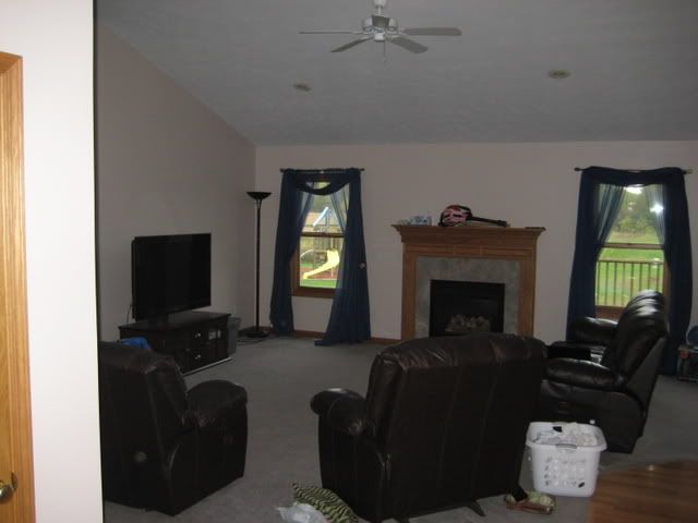

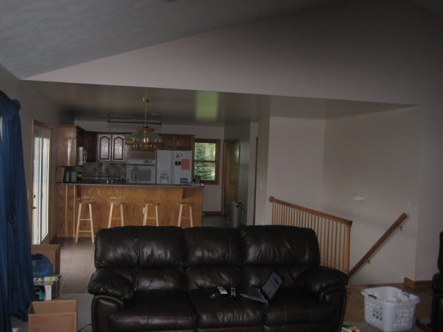

I know I forgot to mention this, but I also have cathedral ceilings which are going to "echo" the sound. Does anyone have recommendations of av stores other than Best Buy, Circuit City, etc. in the SW Michigan area? I really want to set this up the best way possible.
B
bkbond12

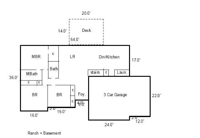

Sorry for another post, but after this one I can post a picture of my home layout.
B
bkbond12
Here is a layout of the first floor of my house. You get an idea of the dimensions a little better. I could also use suggestion on how to mount surround sound speakers in the back of the living room since I don't have an attic to get into there. Anyways, I appreciate everyone's time and suggestions, hopefully I get this figured out the best way possible. Thanks.
Please disregard the clutter etc., we just moved in and are trying to get everything arranged (man, previous owners had some ugly curtains).

hoo boy...
acoustically, you've got yourself a rather difficult room there, bkbond12. There's honestly no way to know how the room would react acoustically without in-room measurements on that one. Standard equations can work fairly well in a perfectly rectangular room, but obviously, that is not what we have here :p
To be as direct as I can be - if you really want the very best sound possible, you'd be best served to focus first on acoustically treating your room and to worry about speakers later.
Now, you could go the full blown route with a company like Rives Audio, but I think what would be more up your alley would be to try out the free room analysis offered by Auralex
I used the Auralex analysis myself (albeit, in a perfectly rectangular room, so it was more simple than your room) and I found them extremely polite and helpful. And it's free...so honestly, what's to lose?
I really really would recommend that you give that a go first because the biggest factor by FAR when it comes to what you will hear in your room there is the room itself. To put it bluntly, without some room treatments, the "best" speakers in the world are not going to sound like the best speakers in the world in that room. There are just too many acoustic issues to be able to really say that any particular speakers are going to be your best choice in the room as it is now, without treatments.
All of that said, here are some basic ideas I have:
1) Like raptorzfan, I think you will be best served with a 5.1 speaker setup using monopole surround speakers. You have a similar sort of situation where you have a large opening behind your seat to a kitchen/dining area. Use of diffuse di-pole or bi-pole speakers as surrounds would lead to an overly "fuzzy" sound as the sound reflects all over the place back there before reaching your ears. A 7.1 speaker setup would require that you place speakers in your dining area, which is obviously unattractive. All in all, a 5.1 setup with monopole surrounds is just the most simple and attractive way to get a good surround experience.
2) You will likely be able to "get away" with using just one subwoofer - although you cannot expect every one of your seats to get an even frequency response that way. The thing is, with so many openings to other areas of the house, room modes (nulls and peaks) will be less of a problem for you, so using two subwoofers to even out the frequency response won't be as necessary for you. That said, you will need a VERY capable subwoofer, because, in essence, you have to pressurize the ENTIRE open area. Bass does not "play nice" and confine itself just to your listening area. It will "spread out" and attempt to fill any area it can reach, so you need high quality, prodigeous output from your sub or subs.
Just looking at your room and arrangement though, I think positioning two subwoofers would be problematic and aesthetically unappealing. You've mentioned the SVSound PB13-Ultra. Certainly that subwoofer has the sort of quality and output capability that you would need, so it could be an excellent choice. For considerably less money though, the av123.com MFW-15 has very similar quality and output capability - albeit in a physically larger case though.
I've not heard the new MTS SVSound speakers for myself, so I cannot comment directly on them. As I said in my last (long) post though, they are certainly well made speakers (at least, going by my experience with their SBS speakers) and I would be rather shocked if they were not able to make you happy with their sound quality. If you love the looks and styling, a MTS speakers with PB13-Ultra subwoofer combo would most certainly be an easy "thumbs up" in my book.
For placing your surround speakers and routing speaker wire to them, what might make the most sense is this:
1) Use stands to position the surround speakers and then run flat speaker wire under your carpet. When I say flat speaker wire, I mean something like this Stick to the perimeter of your room as best you can, but the flat speaker wire can easily go under the carpet without being noticed.
2) wall mount the speakers and then use paintable raceways to run the wire.

Great advice. Thank you. I hate the idea of using raceways as I hate the look of them. The crappy part is with the cathedral ceiling, running the wires up the wall and across the attic is impossible. I have a basement type alternative, but it's going to be damn difficult with my finished basement and drywalled ceiling. Anyways, I'm going to give Auralex a try and see what happens. Once again, thank you.
