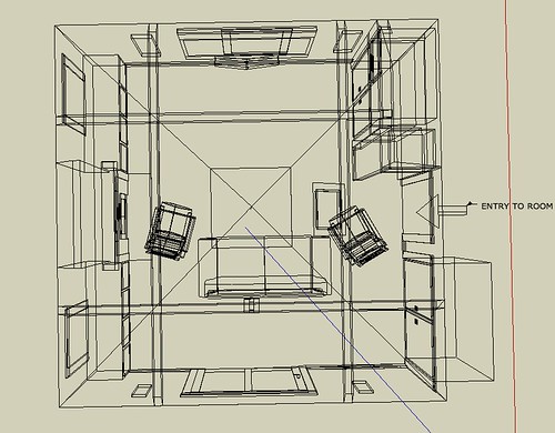

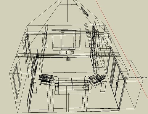

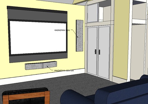

Here are a few mockups to look at, but basically the room is a 20x20 square with a peaked roof at 18'
The IB would be under the floor with an outlet under the screen.
