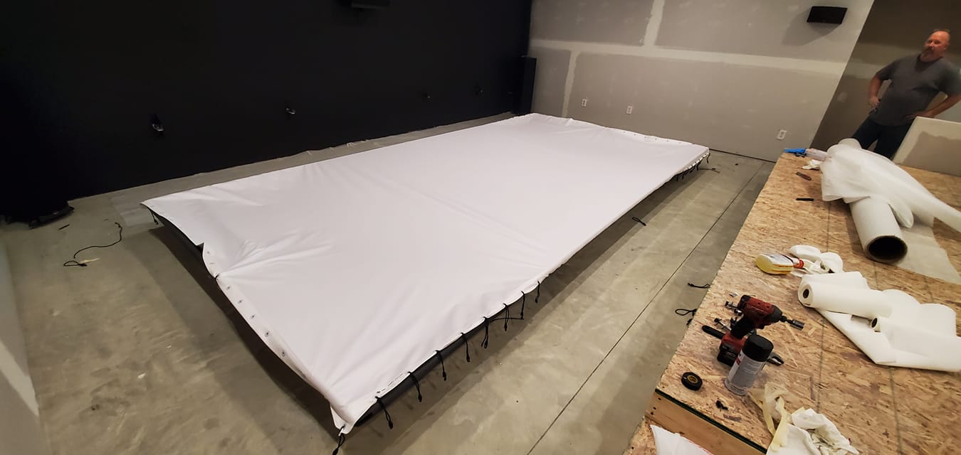

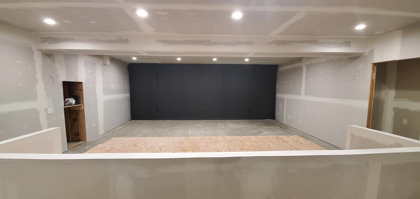

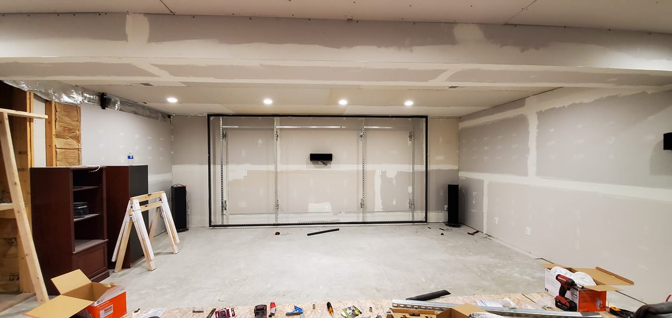

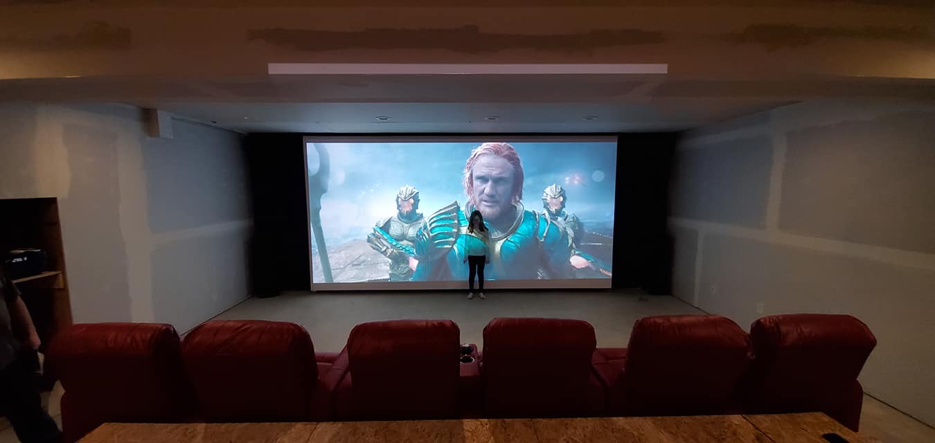

I built a frame out of Unistrut and associated brackets that we lag bolted to the wall. It is about 10" off the wall to accommodate my center channel, but you could easily just make the strut sections a little longer to be at 3' off the wall if needed. We initially wrapped the edge of the frame with pipe insulation but the screen manufacturer didn't give us as much "extra" as we figured so we just wrapped it around the strut without the foam you can see around the perimeter in the 2nd picture The screen is wrapped around the frame and held in by small bungy cords. I painted the wall back so the screen looks like it is floating. The room is far from done but I wanted it functional for the super bowl. The screen will come back down to finish the drywall as well as paint and carpet. Sceen is 200"x100" so I can view either 2.39 or 16:9

View attachment 33926View attachment 33927View attachment 33928View attachment 33929
Very very nice that's coming along well! Can't wait to see it finished
