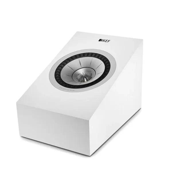

i have seen they have these atmos speaker q50a. they would really help to declutter the front wall when used as heights. can you recommend those type of speakers as heights or are they in general a bad idea perfomance wise and a waist of money? (they cost 600 a pair...)

i have seen theyx have these atmos speaker q50a. they would really help to declutter the front wall when used as heights. can you recommend those type of speakers as heights or are they in general a bad idea perfomance wise and a waist of money? (they cost 600 a pair...)
Depends on how you use them. As Bouncy-House speakers... I wouldn't spend the money, but if you mount them properly up high, they may be a good option.
Still, keep your eyes on the prize and work your way up to the Atmos or Auro installation.
Either of those situations using Top or Height Speakers is very dependent of having the Bed Layer properly placed and dialed in.

i would use them on the wall as front heights to declutter the front ball a bit. i am thinking about maybe using two of the kef centers as FL FR and then those atmos speakers as front height and the q150/350 as surrounds. expenive but would fit all my needs
You would be far better off not using the Center Designs as vertical L/R Speakers. My opinion, but they are not going to give you the imaging that you will want if you are investing that kind of money.
