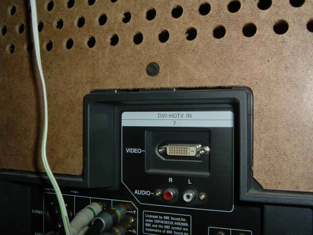

Take a CLEAR photo of the DVI connector on the back of the TV and post it here.
Please do not start duplicate threads as they will get shut down. It's poor forum etiquette. You need to show a bit of patience, honestly we are trying to help.
The user manual for your TV doesn't show which variant of DVI input it has.
Hope this helps. Sorry about the double post, I thought I might have posted in the wrong spot.
