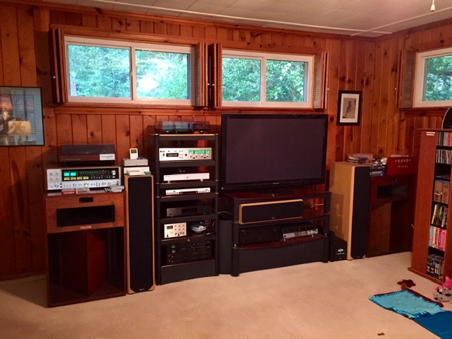

Hello, all. I now have a handle on my new rega p-6 and want to see if there is a simple way (maybe stereo preamp with bypass, though I am just learning of this and will need guidance) to get better quality stereo sound from my albums and stereo sacds. Here is my setup:

What's the problem with the audio now?
ps What are the large speakers? Are they not in use? Speaker placement generally does not look good.
I think Stereo Preamp with HT Bypass is pure gimmick. Just use the AVR by itself.

No problem with current system - just wondering if I could wring out anymore Sound in my 2 channel listening. The large speakers are Klipsch LaScalas That I use in a separate quadraphonic system powered by the Sansui 9001 and many of the components in the rack.

Thanks Leemix! I have the speakers out 12 inches from the wall and the sound is really wonderful as is. Not ideal to have my LaScalas right next to them, but really does not seem to matter to my ears for some reason. I have a wide soundstage and vocals and instruments are clear and easy to place. And people are always amazed not just how good it sounds, but I can crank vinyl like Imagine Dragons and shake the windows on the across the street neighbors‘ house! Exaggerated a little, of course, but the sound is good to my ears. I don’t really have local places to hear high end equipment, so thought user opinions would help guide me. And being on a teacher‘s salary Means saving money is always a good thing. Thnaks!

For two channel, I listen through pure direct mode on the denon through my axiom M80s. The synergy is nice. I use the 5.1 Axiom matching setup for multi-channel sacd’s and tv and movies. I can listen to 2mchannel albums on the sansui and Klipsch, but don‘t know how much life is left in that wonderful At20ss and it’s stylus, so reserve it for quad.

I will probably have more questions after hearing your input, but also include any other solutions. I want to consider all options. My ears are 56 years old, so I imagine they may not appreciate but so many steps up in improvement. Sad, but true! Thanks in advance!View attachment 35687
It's not the AVR, it's the room and layout.

I think working on better speaker positioning could do a whole lot more for your sound than a pre amp or separate amp.

Yes, you are right, but I have a good mix of aesthetics and wide variety of music options that sound fine, so that one will be left alone. It does have reflective and absorptive components, and probably works better than its measurements would dictate.
It also has things blocking the sound from the speakers on the right side, vs nothing on the left side, which makes a big difference.
to the Op, you asked for 'better quality stereo sound', with regard to the pic you provided lovin is 100% correct, your speaker placement is not good ! Improve it and all things 'stereo' will improve, imaging, soundstage, etc
