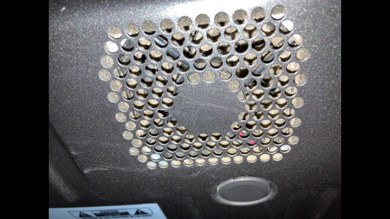

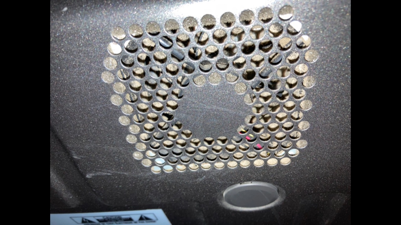

I took tv apart got it this clean, now I can’t get all the screws back were they belong … they were so covered I had to use a toothbrush to clean the fans and mists of water on the brush . Got 96% of the dust i think. :D

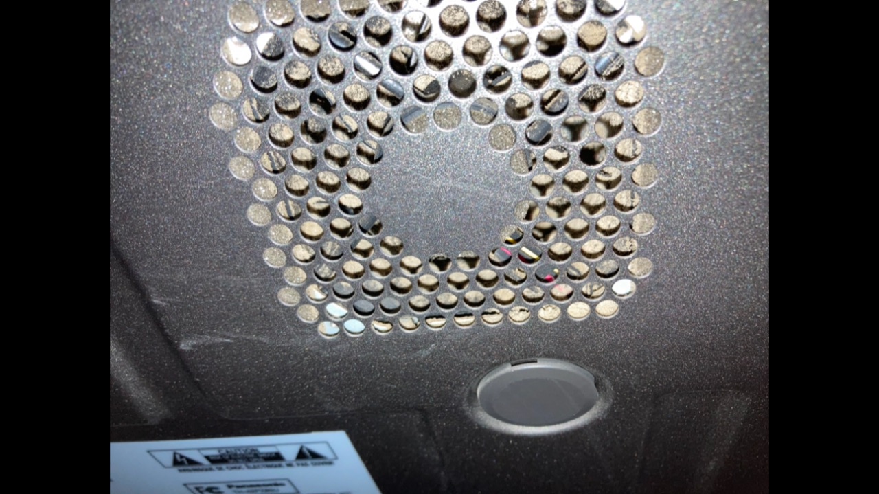

Generally you want to use alcohol and q-tips for this type of cleaning work. That's some pretty gunked up stuff right there. Before pics
Didn’t think about alcohol i should had waited longer to clean it.

I’d have take the back off again to clean it 100% and I can’t get to the front of the fans . Probably 90-92% or more of the gunk was removed the camera flash just made it loook worse. Before pics

I’d have take the back off again to clean it 100% and I can’t get to the front of the fans . Probably 90-92% or more of the gunk was removed the camera flash just made it loook worse. Before picsView attachment 60322View attachment 60323
When is the last time you cleaned your TV ?, that's a lot of dust even for a year. I would also recommend changing your AC/heater filter in your home if there is one. Dust acts like an insulating blanket, preventing the necessary convention cooling and that can decrease the life span of the electronics. It might not burn out your fans, but jus think if the impact to the other components. Based on the TV, just think of the amount of dust in your AVR and other equipment, not to mention your lungs. Maybe 4 times a year , clean the equipment.
I just cleaned it look at post 6 that’s post clean ,#9 prior to cleaning.
