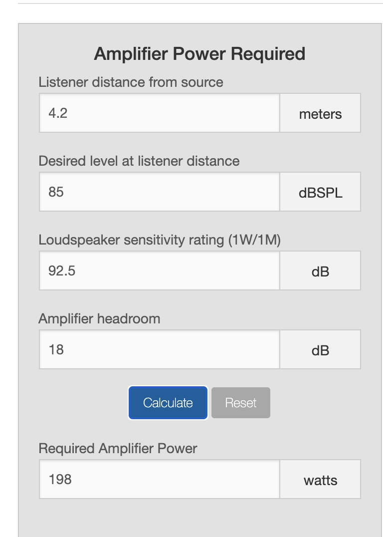

howdy folks and thanks for all the responses. perhaps i phrased my original question poorly so I will try to rephrase: does room size alone affect amp power requirements? it sounds like the answer is "only for base / subwoofer frequencies" but let me make sure I am understanding correctly:
Example
Let's assume we have two rooms where speakers, positioning and target SPL at listening position are the same:
* target SPL of 85 db sustained / 105 db peak at listening position
* 2.0 setup with speakers: Focal Arias 948 x2. 8ohm nominal, 2.5ohm min; sensitivity: 92.5 dB SPL (1 W/1 M); recommended power range 50-320W
* distances: between speakers = 9ft; between either speaker and listening position = 14 ft
No suppose we have two rooms:
* A: 16ft x 20ft
* B: 24ft x 30ft (wall lengths 50% greater vs room A)
Will room B require a more powerful amp than room A to attain the above SPL? If so, how much more / is there a way for approximate?
For example, using Crown's amp power required calculator I get required amp power of:
* 314W with 20db headroom
* 198W with 18db headroom
...but, again, no mention whether a much larger room would drive up required power for the same target SPL?

I mean, if you sit further from your speakers (distance) because the room is bigger (volume) then yes you'd factor it (the distance) to figure out your power needs for your speakers.
Room volume comes into play with subwoofer frequencies, not so much mid to upper frequencies for speakers.
