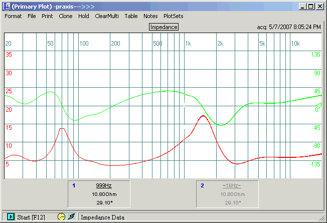

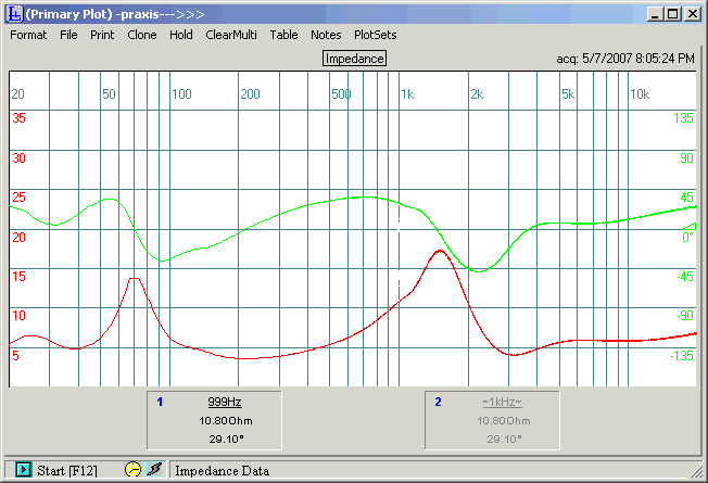

Here is the Impedance curve for Salk SongTowers as originally designed with SEAS CA15 woofers. Now ER15 woofers are used, but I don't believe they significantly change the impedance profile.
Yes, and that raises another issue. That 3/4 inch dome. The impedance curve shows the crossover to be in the 1.5 KHz region, which it would have to be given the bass/mids involved. The Tweeters are the very expensive Hiquphons. I think they use the the OW 4 now and not the OW 2, but the specs are almost identical. Recommended crossover for those tweeters is second order at 2.5 KHz. The impedance curve certainly shows the crossover lower than that. Hiquphon say at their recommended crossover point speaker power handling would be 100 watts. So in the Salk it will be a lot lower than that. The Fs is 850, so the tweeter will barely be 12 db down at resonance. Hiquphon do not quote tweeter Q which they should. If it is a low Q tweeter you can drive it down below Fs.
I just have a feeling that if I owned those speakers I would have replaced a tweeter or two.
I also agree with the reviewer in the Audiohics review that those speakers are ported speakers and not TL, although there is some damping of the first impedance peak. Bass roll off appears to be fourth order, which is ported cabinet behavior and not TL.
