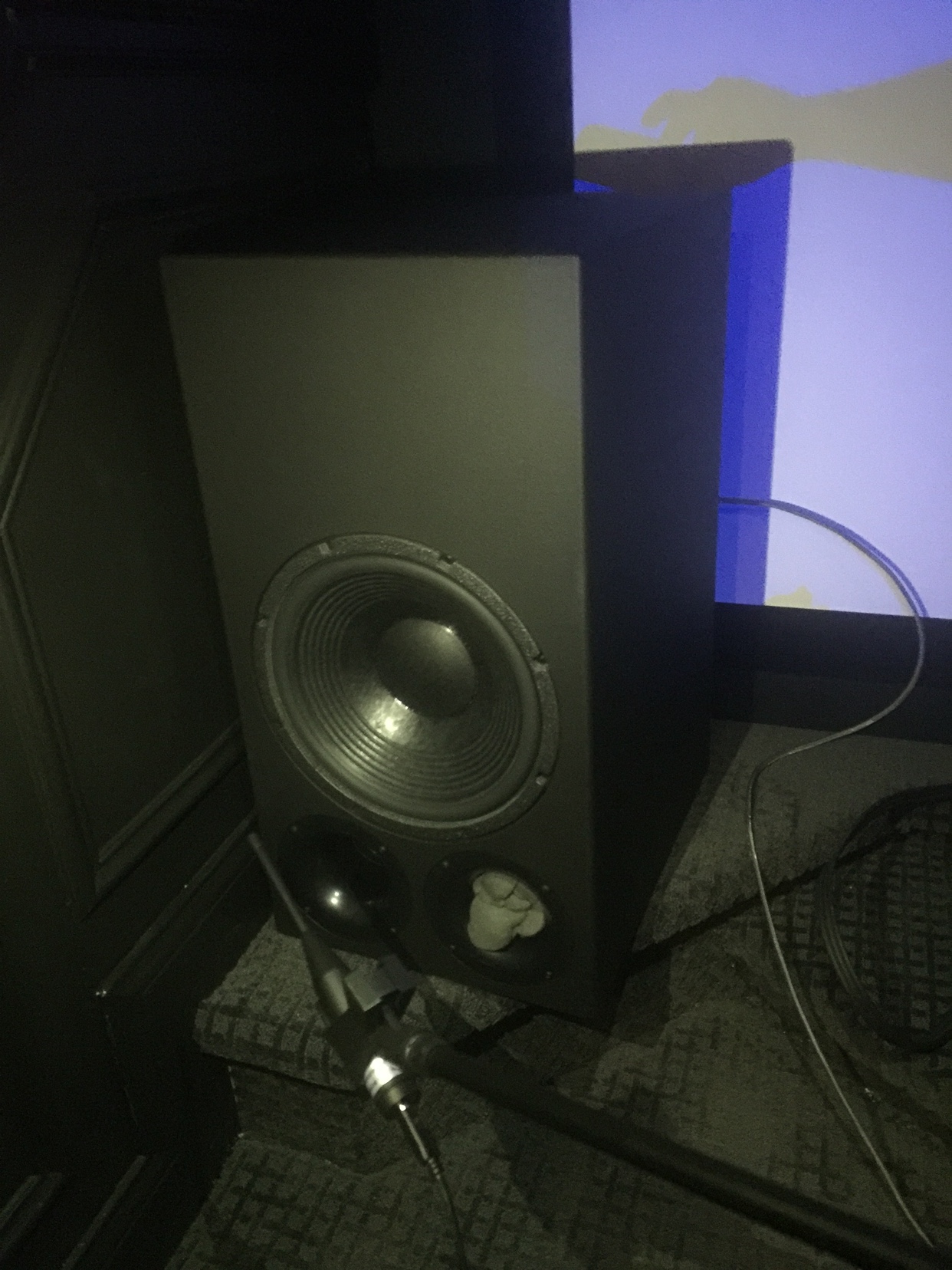

The sub your using was launched at my GTG meet that was posted in Avsforum. Matt mtg90 designed that box for and Erich had a cnc company make the cuts so he could sell the flat pack. I use the DatsV2 to prove the tune of box after running the numbers through winisd. I have two of these drivers like but I built a custom box to fit my space for mbm In Our family room. That box is not tuned for 63 hz or what was posted. Run the dats on it. Here’s the original box at my house that Erich sells before DIYSG even sold them.

It was not tuned to 63 Hz. Read the post. It was however optimally tuned for the cabinet and driver.

So where is the opitmal tuning? Where you had me do a 7.3 inch port for my boxes? Where is mine tuned at?
So go to post 11 and open up the pdf. of your sub model. Now near the top you will see Fb. That is the box tuning frequency. As stated before that number is NOT how low the sub plays. If you look at the impedance curve, you will see the answer to your question as well. The tuning frequency is indicated by the null between the two peaks of impedance. That is right at 38 Hz. Now look at F3 which is the 3 db down point.
Now look at the first response graph and see where F6 is. You will see there is good output maintained to the mid forties. In fact the 6 db point is right on 45 Hz.
Because the driver is low Q it allows for an extended bass alignment, where the initial response fall off is a little less steep than usual.
This is what you wanted and optimal for your driver. This driver is a good driver, but is highly sensitive and therefore will not play really low. But you wanted a so called mid sub and that is what you got. One that is ideal to cross in the mid forties. So that is where the 6 db down point is and should be for your application.
By your post 41 it sounds as if it delivered as advertised and then some.
