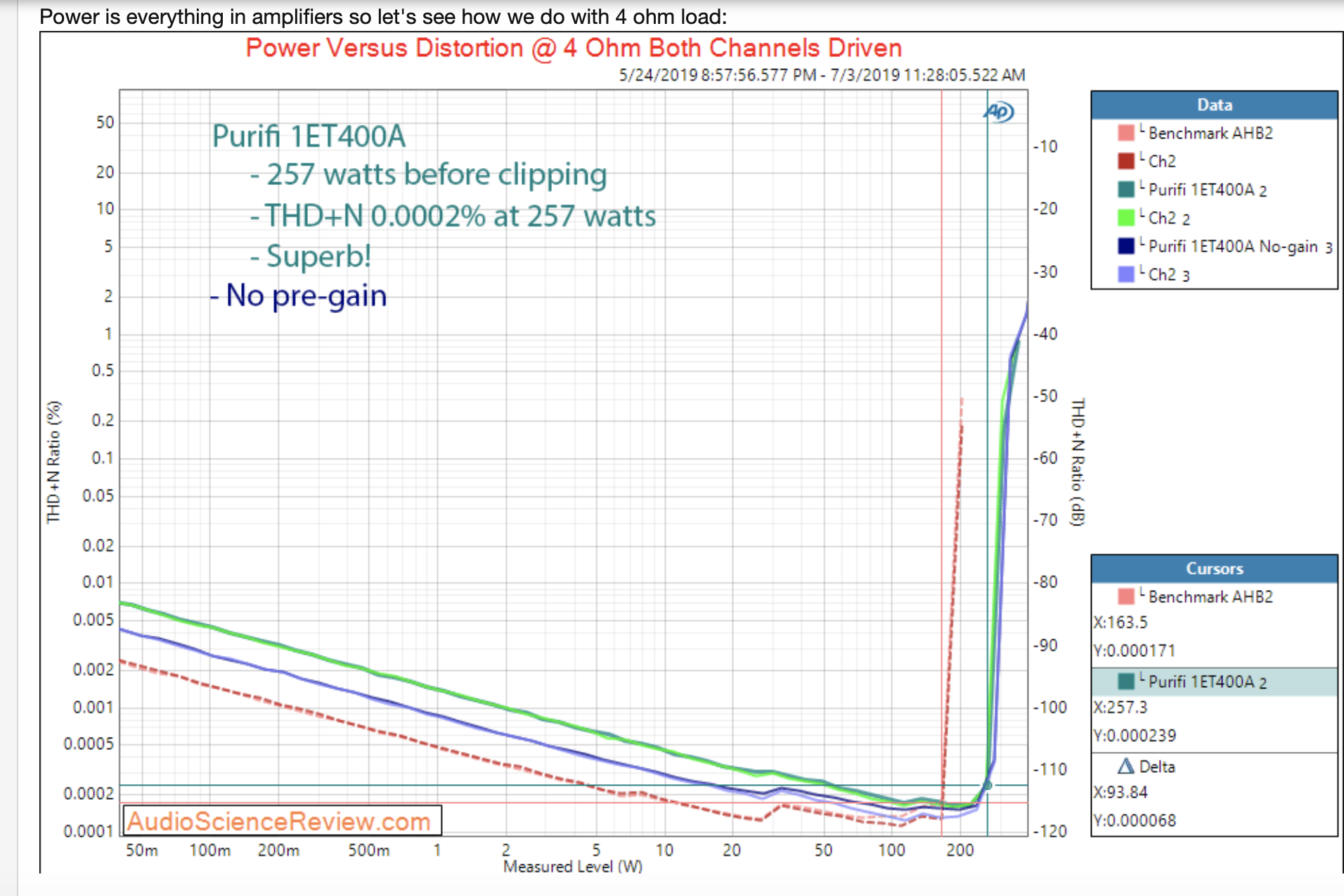

Now, on a slightly different topic, the 1ET400A's output specs you listed are based on 1% THD+N. I am not saying 1% THD is audible, but the numbers would be much lower if you based the outputs on say 0.005% THD such as the levels that ASR typically used when measuring the Denon AVRs.
