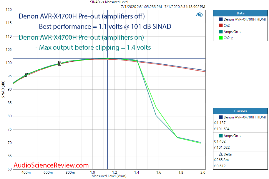

I thought your questions have been answered many times over a ASR and AH. Anyways, if you have the AVR-X4700H paired with the Monolith 200 W amp you should be fine. Below are some facts:
Monolith 200 W amp gain is 28 dB
Denon/Marantz AVR gain is about 29 dB
Amir comments on needing more than 1.4 V for amps like the Monolith was based on not using preamp mode. If you use preamp mode, the power amp section's inputs are disconnected from the AVR preamp/proc outputs so the pre out signal will remain very clean to > 2V.
The Denon/Marantz specs say 1.2 V rated, but we don't know their basis, it could just mean 1.2 V when the internal amps are driven to their maximum output, but we can only guess. In the service manual it shows pre out maximum 4.2 V maximum. In the THD+N vs output graph they sent Gene, it also show >4 V, so you have nothing to worry about.
In the ASR review, the SINAD vs Measured level graph tells you all you need to know:
@PENG - so you think whether the external amp gain is 28 or 26 it makes not difference with the Denon 4700?
I would never say that!
Use 1.4 V as example:
1.4 V input to a power amp with 28 dB gain, power amp output will be about 154.6 W
1.4 V input to a power amp with 26 dB gain, power amp output will be about 97.5 W.
The difference is not insignificant.
For a 200 W rated (8 Ohms) power amp, you need 2 V input to use its full rated output. So whether that matters or not, depends on the power you need. That's why it is important to take the first step, that is to figure out your power need, before shopping for power amps for you AVRs, or even AVPs.
