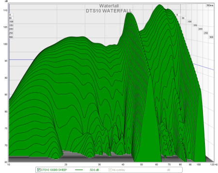

BillyP's $2400 sealed PSA sub wasn't locatable at all. Same with Rick's Epik Empire. That was like being in a drum. It just came from everywhere. The subs I'm talking about aren't anywhere near that level ... if it's a boomy high q sub, would the transient response be at the same frequency as the fundamental?
You will generally see some resonance associated with a peaky/boomy response. You can see an obvious example of this with Josh's measurements of an uncorrected Danley DTS10:
One other thing to keep in mind with crummier subs beyond their own buzzing/rattles is that high order THD could be a contributing factor as well.
