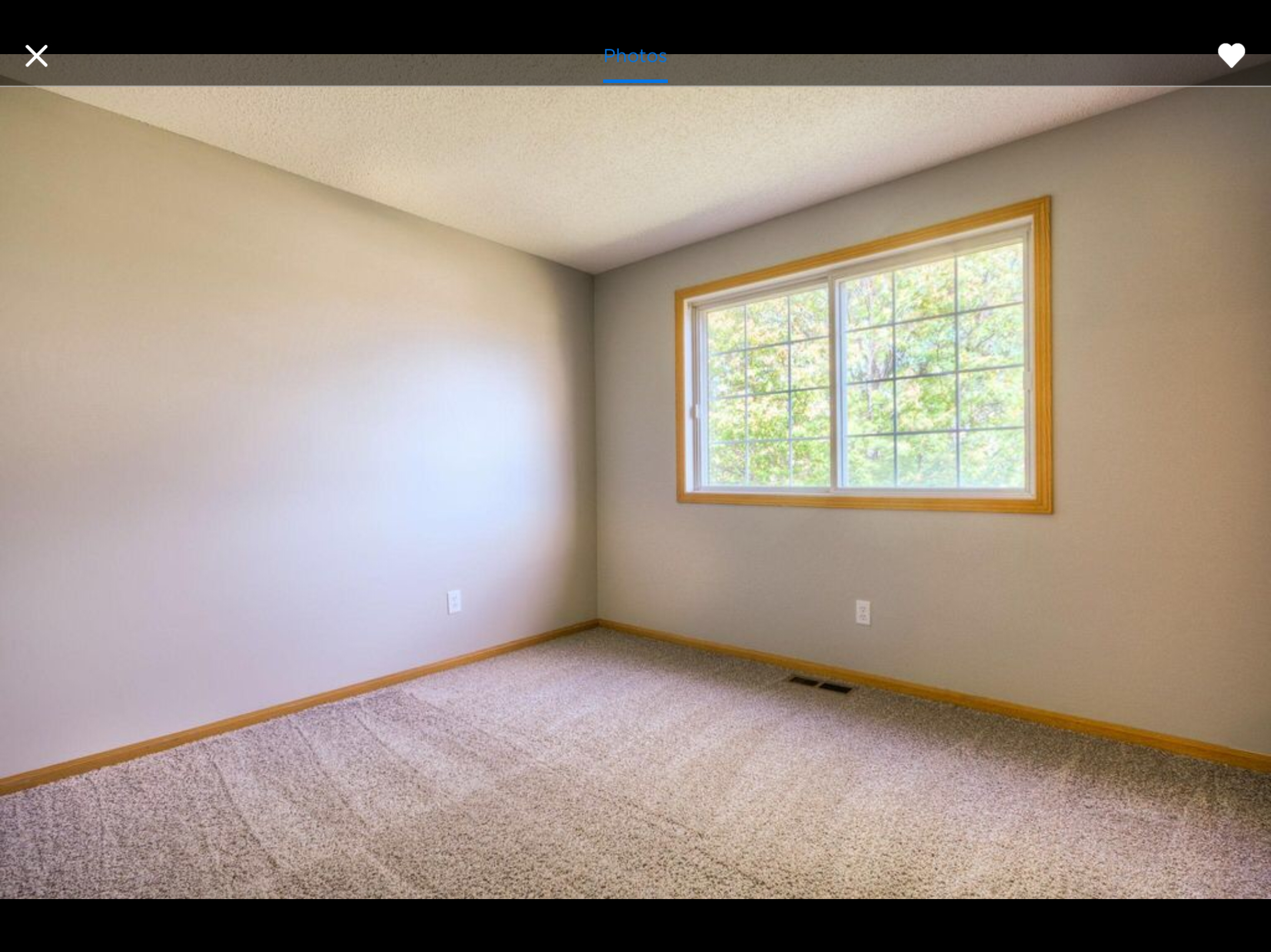

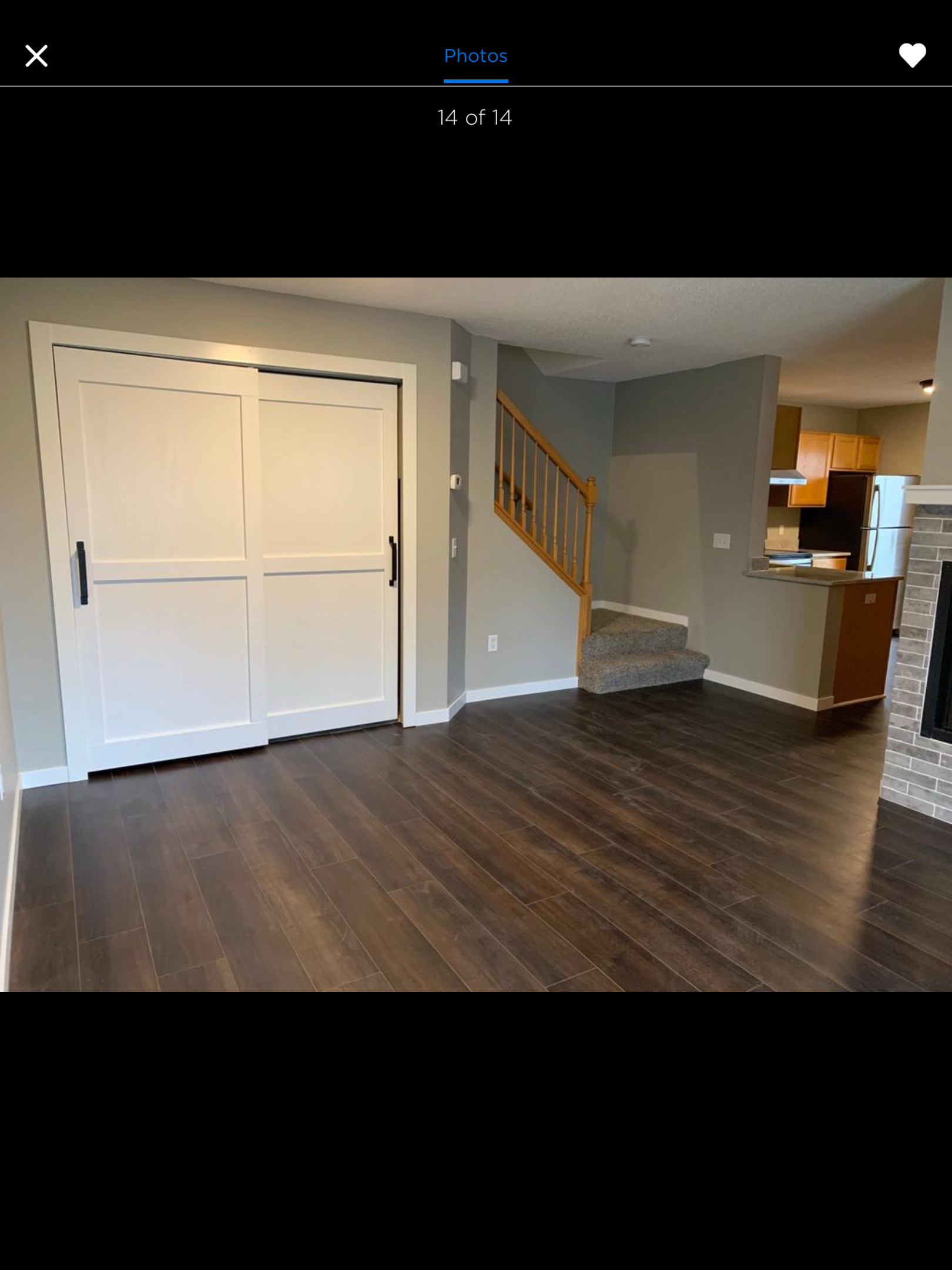

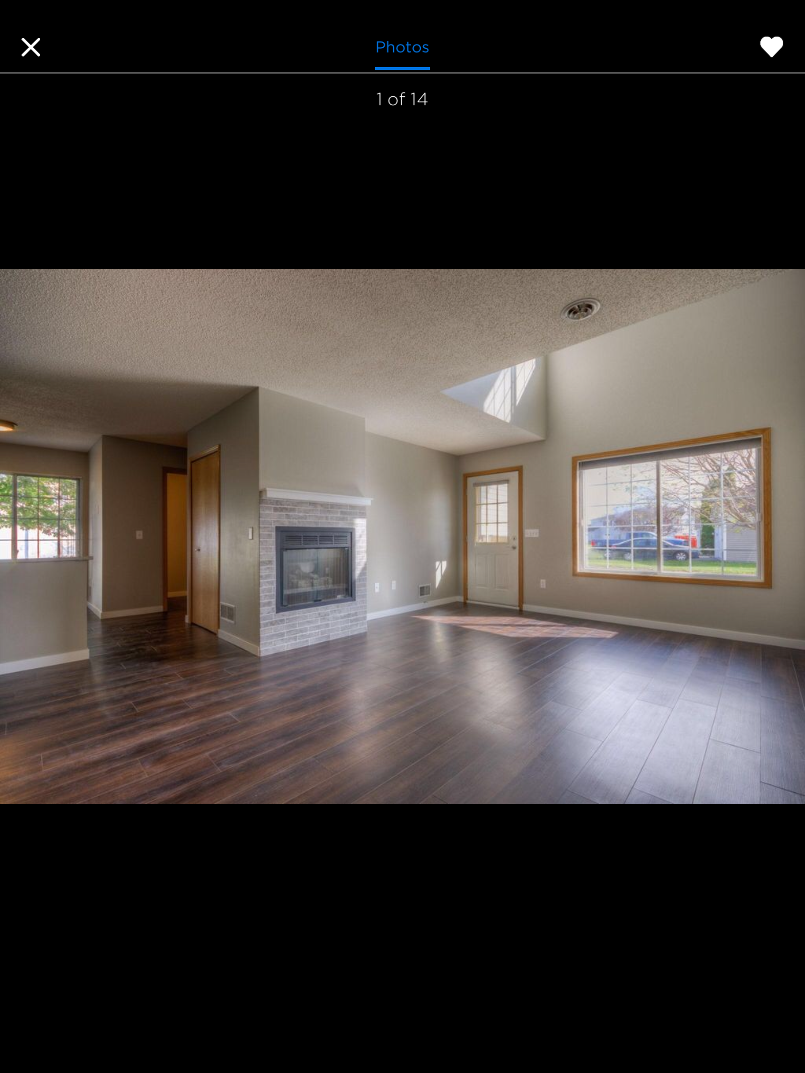

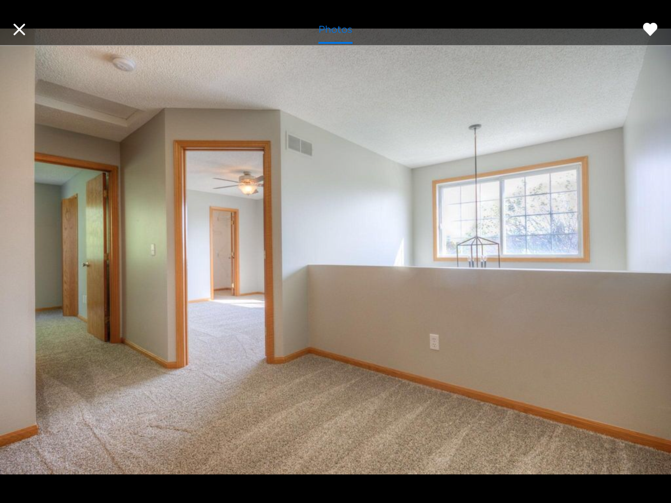

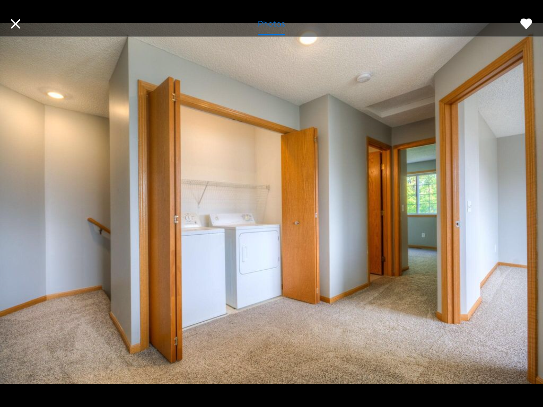

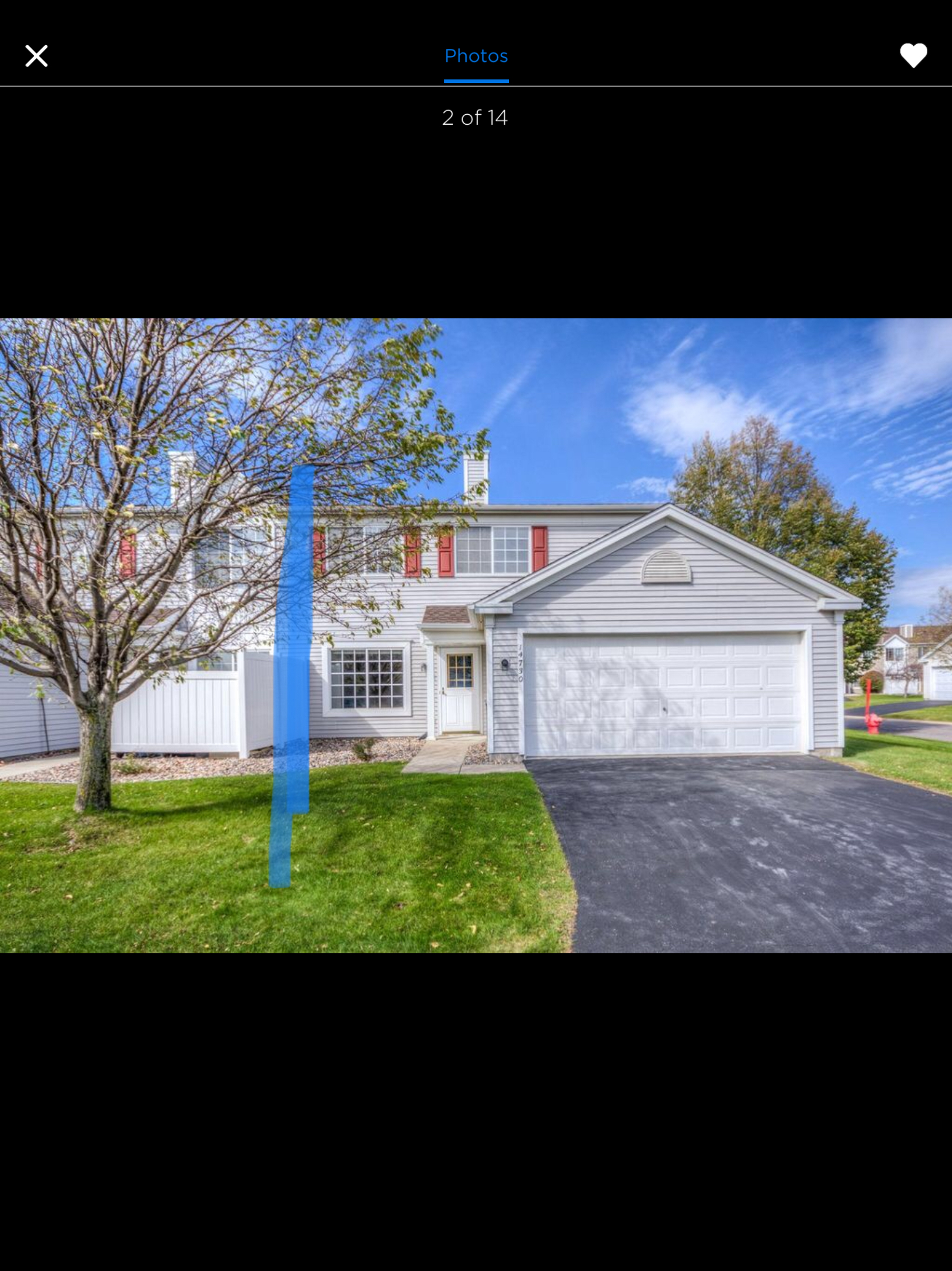

So the wall is a “ fire wall” the property manager said. And the 2nd bedroom could be anything. Would probably put an office there but are you thinking about setting a system up in there? It’s pretty small but I’m open to suggestions.
So the opinion is that they’ll hear anything no matter what? I mean I’m in a tough place because idk where I’ll be a year from now so I don’t want to purchase a system based off a 1 year lease. But you think even keeping it at relatively low volumes and getting quality items would be heard as well? I’m just feelings clueless atm because the idea of upgrading and getting a real system really excites me and I can’t go back to my Vizio m-65 c1 built in sound.
I wish I was of more help and had more information but that’s why I turned here. Thanks for the responses though, I appreciate it.
I added photos of the 2nd bedroom btw

The Garage looks to be pretty far away from the shared walls.:)
Nice looking place and hope it works out home theatre wise.

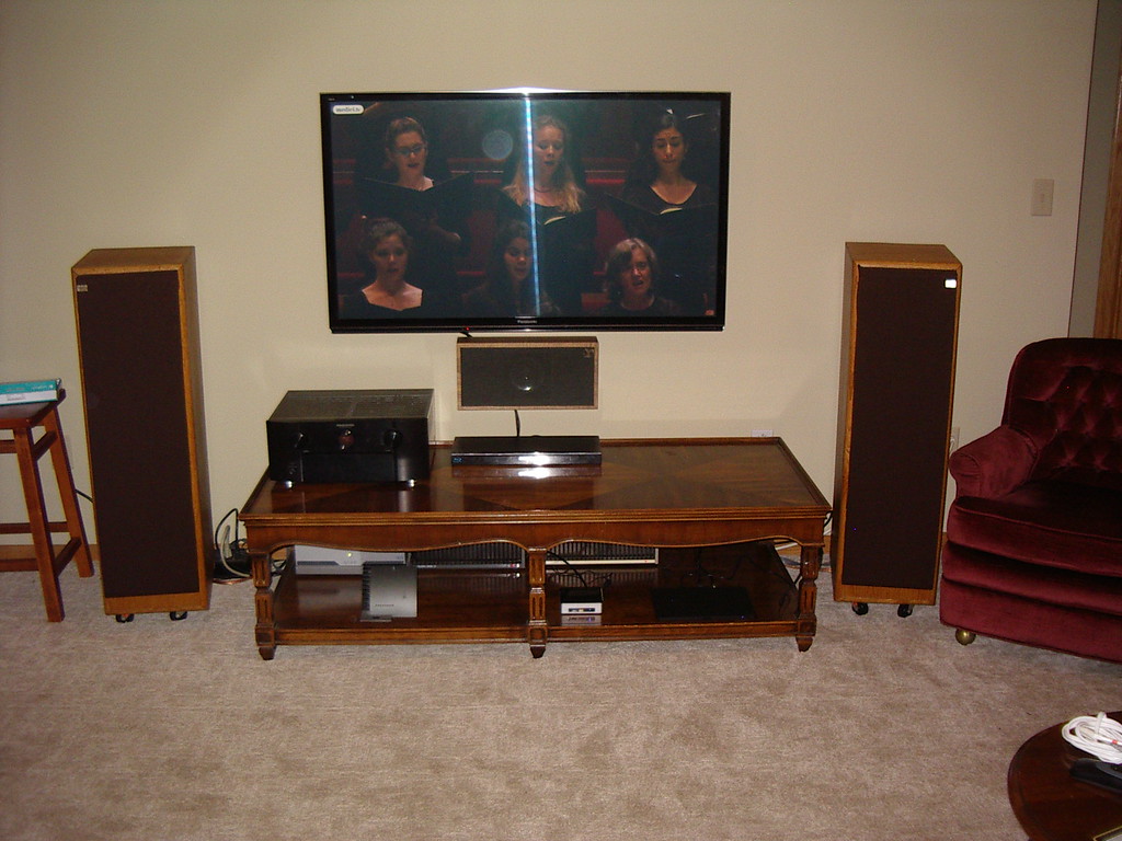

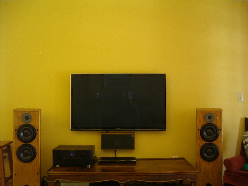

I'm in the process of rebuilding out the AV room from Benedict. I have the system my wife wanted up and running in the main living area. I have the family room system up and running and hope to have the main AV room up and running in two to three weeks.
Now we had a very nice system in our Town home condo. It had a shared wall. My wife loved that system and we never had a complaint from neighbors in 11 years we owned it.
The drivers you see were in sealed enclosures, the speakers contain two 9" Morel sub drivers in isobarik second order coupled cavity configuration with F3 in the mid twenties. The sound was nicely balanced and we played it at realistic natural levels without complaint. They were good enough that the last time a close friend heard them he upgraded his B & W 800 Ds, to the B &W 800 D3s the following week!
So achieving a good natural and balanced sound should not require annoying your neighbors.
So "my wife's" system has moved to the main living area of our new home and is filling a huge area with a newly designed in wall system. One 10" driver is filling this huge space with balanced bass.
This system is now up and running. I will post when the trim is complete. I picked up the polished metal trim for the speaker system today and will install it tomorrow. The powder coated trim for the equipment cases will be ready at the end of next week. I will post more pictures then.

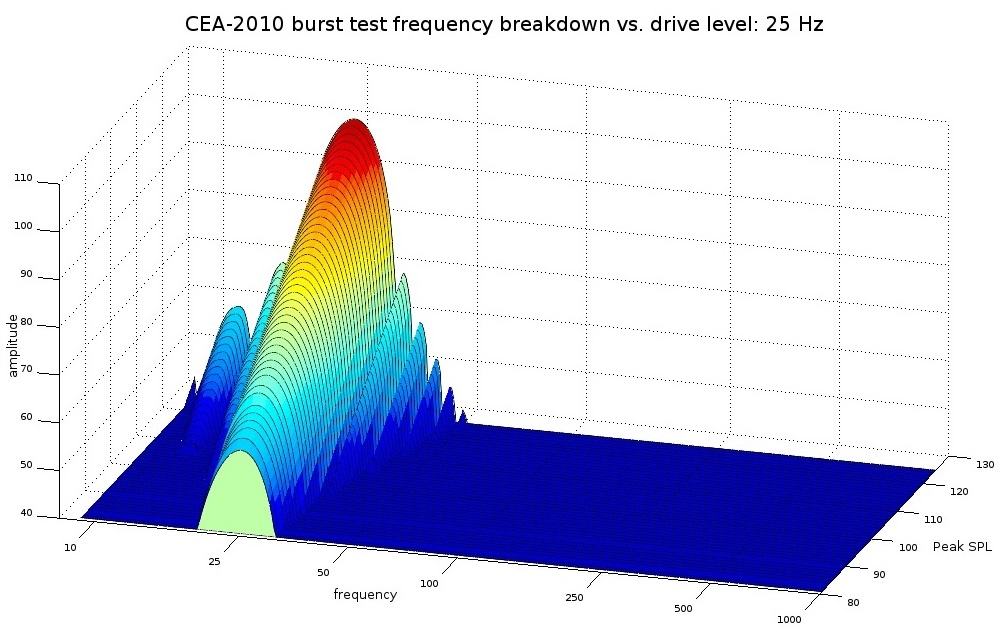

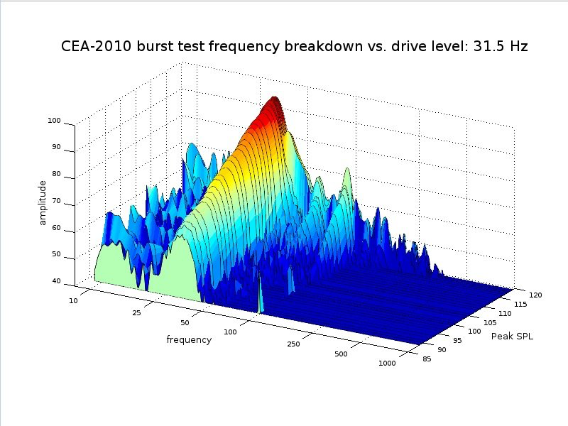

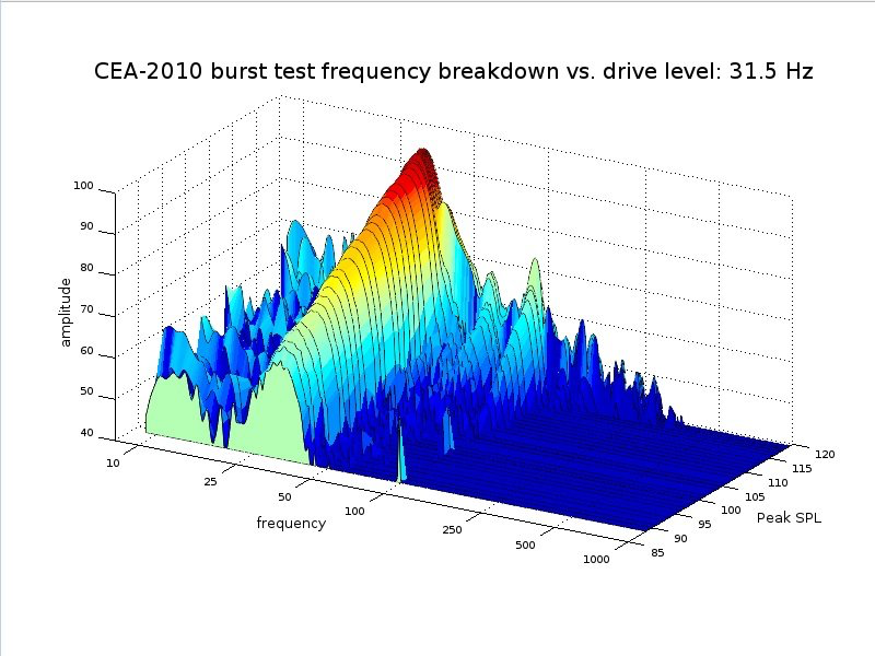

I understand damping, but poor behavior would show up in waterfall plots and burst tests. Looking at the AH review of the SVS PB-4000, just to pick a review of a ported sub at random, and looking at the burst test at 31.5Hz:
It could be cleaner, though James commented that he felt the PB-4000 operated in "a very controlled manner". Is it your contention that the hash measured here would be lower with a TL sub, and that the difference would be overtly audible?
shadyJ
Speaker of the House
Staff member
Firstly, Irv, bravo for using those graphs! Glad to see someone is paying attention. Secondly, could it be cleaner, yes; it could be absolutely perfect with no distortion or noise whatsoever. Here is what a theoretically perfect measurement would look like for that:
But the PB-4000's burst performance at 31 Hz is really really good. You can see there that, at the maximum drive level, the highest order distortion, the 3rd harmonic, is still 20 dB down from the fundamental. That would be inaudible. Take it down by just a couple dB and distortion quantities fall dramatically to the point where we are talking like less than 5% THD. Anyway the point to all of this is that while you can have less distortion, it doesn't matter because its all below audibility anyway.
