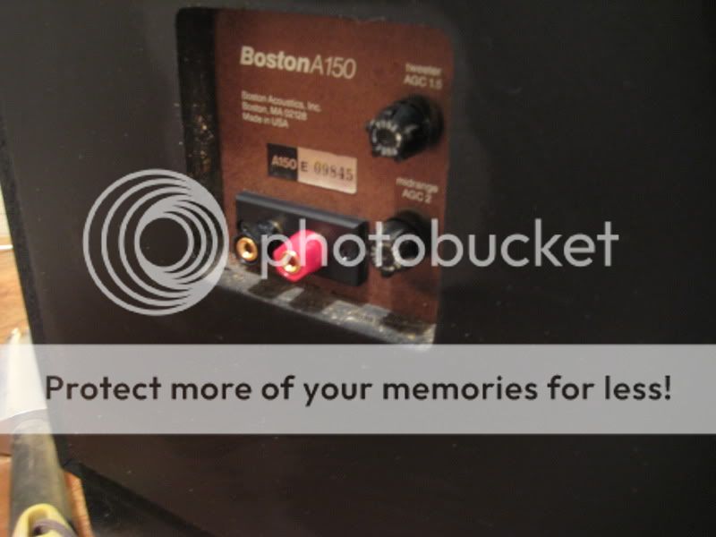

Does the back of your speakers look like this?
If yes, remove those 4 screws and pry the terminal cup out. It probably has a rubber gasket behind it.
There will be two connections behind the cup, hopefully a red and black wire, but it may be more directly connected to the crossover board. Note the color of the wires, or exactly where the connections are made to the board. (If you want a look at these connections from the other side, remove the woofer. It will also have two wires connecting it to the crossover board.)
Measure the diameter of the hole in the back of the cabinet, and order an new terminal cup of the same size from Parts Express (there are 3 pages of choices):
Terminal Plates & Cups in the Speaker Components Department at Parts Express | 321
Guessing by eyeball, this replacement might fit:
Round Speaker Terminal 2-7/8" Gold Binding Post | 260-283
If no rubber gasket is behind the new cup, you can easily make a seal with 100% silicone adhesive or caulk
Swerd
Swerd
I think that this is it
Woops :eek:.
If it looks like that, then he will have to remove the woofer, disconnecting the wires to it.
Then he can disconnect the crossover board from the backside of the terminals, remove that small terminal plate, and install a replacement from Parts Express.
