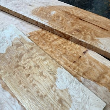

This may end up being a one off project for me, so I may try it, for the sake of expirementation, and if it ends up being stable, then I'll think about selling it. The reason I don't really want to go with a premade ply is because I've got some specific woods I'd like to use. I think these types should be pretty stable, because they're pretty dense woods. Here's some pictures of the woods I would like to use. One is quilted maple, and the other one is Tzalam.
Nice pieces of wood....just not sure why it relates to speaker builds but then I find little use for a bluetooth speaker :)
