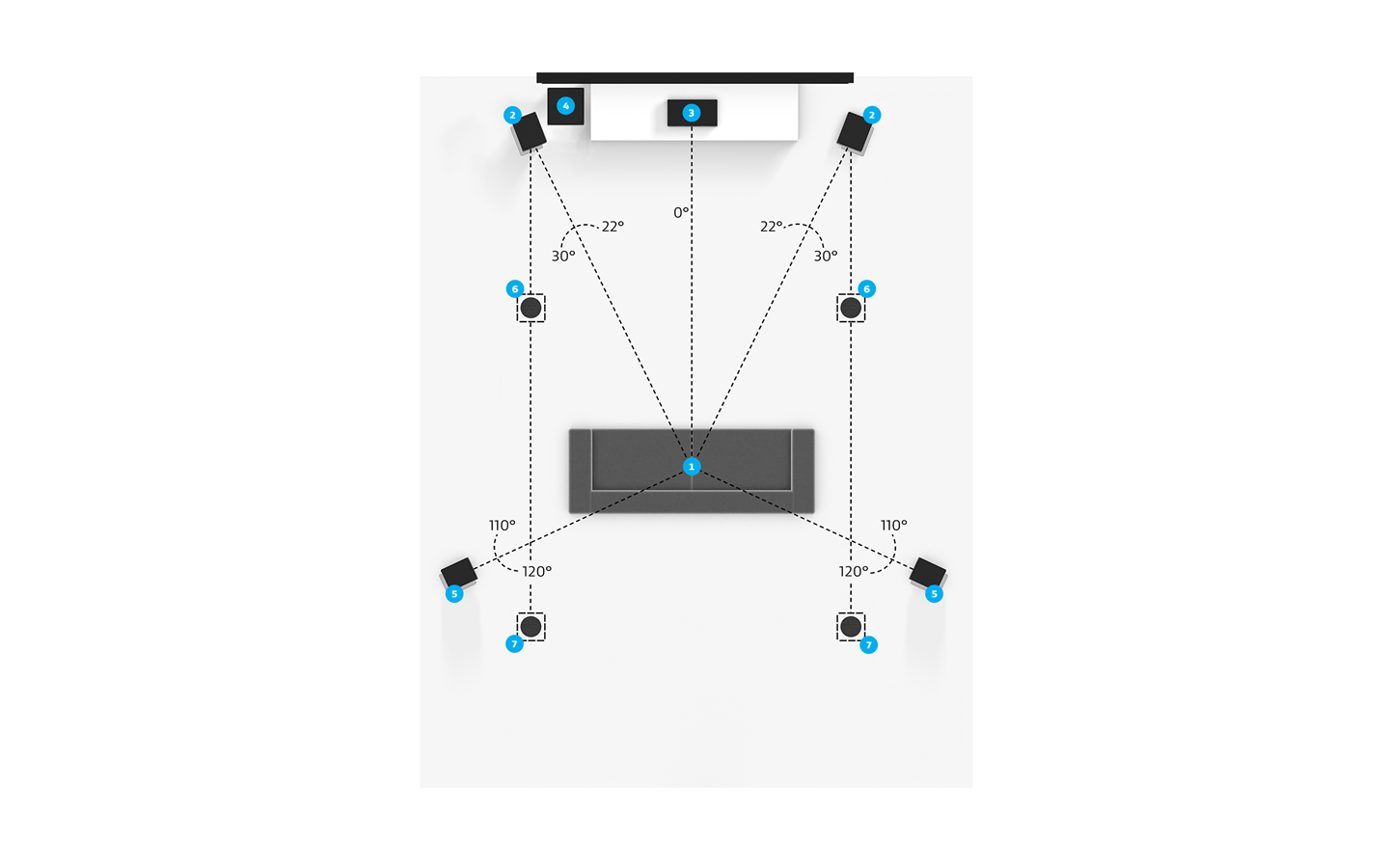

Hello SuperDusti. Welcome. Can you not move the couch forward of the back wall at all? It has an impact on height channel(Dolby Atmos) placement as well.
SuperDusti
Technically I could, but I have an L shaped couch. If I move it forward, it greatly reduces the size of my living room and makes the space behind the couch pretty much unusable without making it look very odd. I was hoping I could mount the surround channels on the ceiling about a foot away from the back wall facing towards each other. The only other option would be to move the couch to near the center of the room and then I could still use the space behind. The issue with this, is that it places the couch about 5feet away from the screen.
Trebdp83
I see what you mean. I have an L shaped couch with the main listening position about nine feet from the screen. You want something similar to this setup for 5.1.4 but furniture can make it difficult for some.
