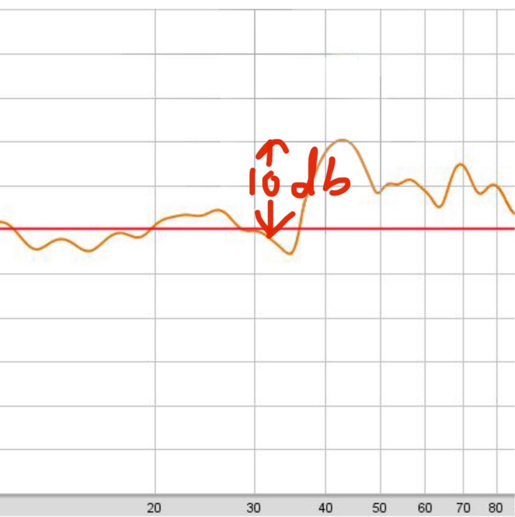

Are you sick and tired of some people saying that your bass is “not ideal” because you can’t move the bass around to the exact ideal location (like separate subwoofers) since they are permanent attached to the 350lbs cabinet? I’ve never had a single problem getting outstanding bass from my towers of power. Maybe these people are just jealous they don’t own towers of power so they have to find some excuses. :D
3db
3db
No, I'm not tired of it, as I know what I'm listening to, which is the most realistic and accurate bass I have ever heard. It is even throughout the room, with not problematic peaks or nulls by measurement. There is just a slight rise in bass response in the rear seats. However most concert halls do this in the rear circles. If you listen in the rear seats, it gives you a sound a perspective like being in one of the balconies rather than the stalls. It is still a very pleasant experience.
Transmission lines produce a bass that is incredibly realistic on all program. It really is a pity that there are not more on offer.
Gene has absolutely said as much on a YouTube video with Anthony Grimani and William Poes. "But they look so cool." or something like that.
As we've said before, there are many variables including room acoustics, which would affect all full-range towers.
If your house is bad or "not ideal", there's only so much you can do even if you were to move your subs to the "ideal location".
So Gene had a 80Hz dip, huh? My room doesn't have any big bass dips.
William Lemmerhirt
William Lemmerhirt
Ummmmmm……… jus sayin
