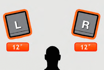

i lost my soundstage, after moving my surrounds, upgrading and moving my subs, running Audyessy a few times, my phantom center in two channel is about two inches! If I center myself, I can hear it but if I move my head literally 2” to either side I lose it.
I am going to try a few things in this article..
Do you guys have any ideas on how to widen the sound stage? I never moved the left or right speakers...
You can widen the soundstage by distancing the front speakers. But you would get a better soundstage by using ribbon or air motion transformer tweeters. These have a wider horizontal sound dispersion than any other tweeter.

I am married to these JBL’s for a few years. What I had was great, I just don’t understand how I could lose it without touching the speakers....
Are you sitting closer to the front speakers? That would be a reason. The change in the soundstage has nothing to do with the moving of subwoofers.

Try using direct just for comparison. I’ve had times where audyssey messed up my imaging too. Make sure you’re 100% consistent with the mic pattern.
Also, my JBL’s that are older than yours seemed to respond to different amounts of toe in. They are a different design as yours have the big horns, but I’ve always found experimenting with toe to be worth the time.
