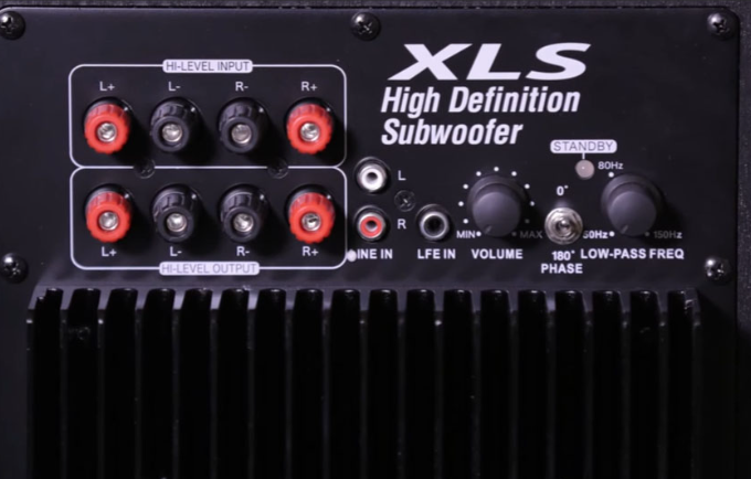

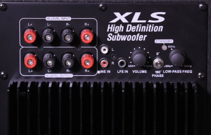

Some subs have connections for speakers View attachment 61002
Those are called high-level inputs, so you can pass your speaker wires thru the sub to provide signal to the sub but the same signal the speakers get (from the amp, the sub doesn't power the speakers via these connectors). Usually for older 2ch systems that have no sub pre-out. I'd use the LFE input on the sub along with the sub pre-out on your avr, tho.

this is what I am using, I thought of getting something else but i have no idea what to look at and what to do with this one, to bad ther wasnt a place to trade infor recycle or something

Your CVs have bass, but not on the order of a good sub. Seeing a driver move a lot isn't necessary (and somewhat unusual too). Do you have that particular sub? Does it have a model number? Thanks for the Yamaha link but I tend to find things just fine with a model number. Do you use the manual to assist? It has tons of good information...

In your Yamaha settings, you would set all your speakers to 'small' and let the receiver handle the crossover of higher bandwidth audio to the speakers and low frequencies (LFE) to be passed to the subwoofer. You would connect ONE RCA cable between the Yamaha and the subwoofer using the LFE input on the subwoofer. You would ignore every other connection on the subwoofer as extraneous. It sounds weird to leave them all disconnected, but I'm sure there is a lot on the back of your Yamaha which isn't connected as well. It's okay.
