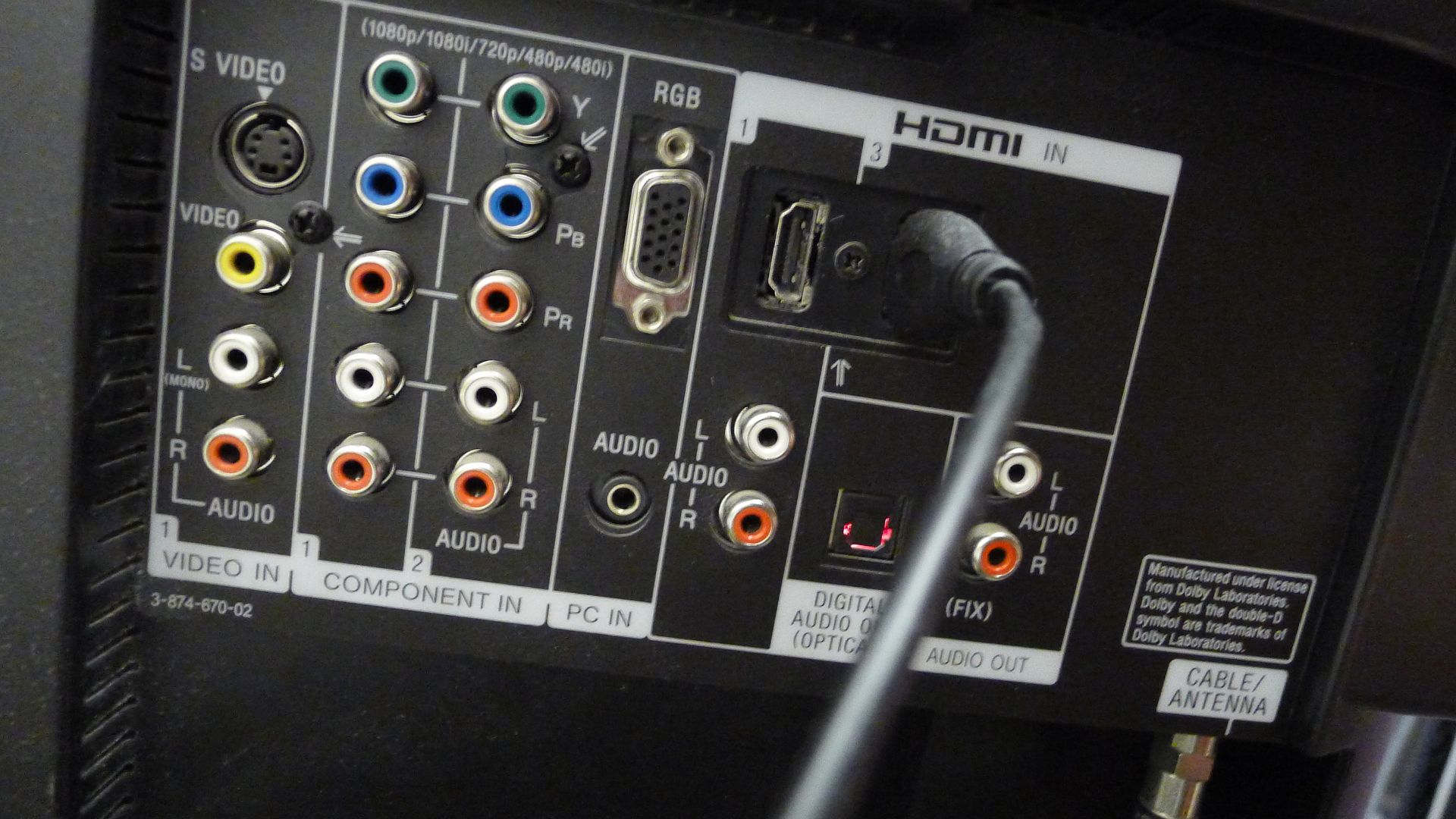

I got the toslink, all 5 speakers work when watching TV channels, the bass turns on but I need to buy the subwoofer cables, and all HT units are in their positions in the room. Besides hooking up the bass, I need to get the receiver to work with my PC via my TV's HDMI mode.
I found out that my TV is just old enough that it doesn't allow for the HDMI > TV > optical > receiver to work; whereas, newer TVs allow it, at least according to this site and what I've found in-person to be true:
https://www.avforums.com/threads/kdl-40s4100-no-optical-out-audio.964943/
If your first suggestion in post #88 falls through, I think it may be that a specific driver needs to be installed for my motherboard, as all of the sound is coming through my graphics card (although newer TVs will work, I think that my TV only accepts audio out from the HDMI and won't relay that audio signal to the optical - maybe there's a driver for the motherboard to tell it to not send an audio signal to the HDMI and only the optical). The issue with this "solution" would be that I'd have to manually unplug the Toslink from the motherboard/PC and plug it into the TV if I want to watch TV.
Assuming that the HDMI converter doesn't work, I may have to upgrade to a new HDTV lol.
