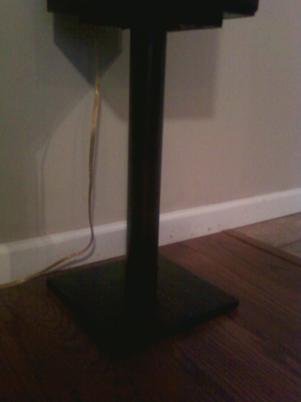

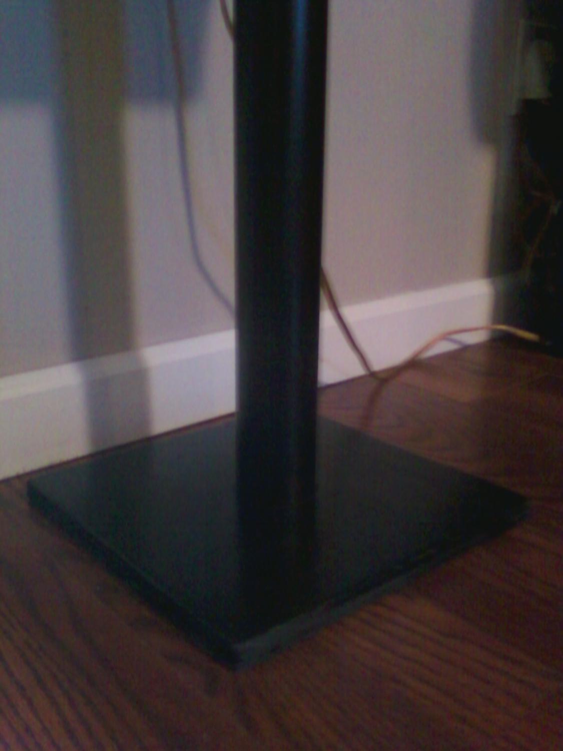

I just built a pair of "Stubby" type stands out of pvc , and was very cheap.They turned out looking really good and work great and was very easy to build. I wanted to try to make them out of 2" pvc because I wanted a sleeker look than the 3" that most use and the 2" supports the speakers fine.Getting the sand in and sealed off was no biggie either.The way I built mine was I used an 1-1/2" wood bit and drilled the 3/4" birch plywood I had left over 1/2" in depth in the center of each end and that gave enough room to put an 1-1/2" flat washer with a nut on each end that seals and tightens the stands together.Let me say the sand makes a big difference , I didn't have the sand and tried them out without it and the speakers sounded a little off so I ran Audyssey and it tried to set them at a 150hz (normally sets them @ 80).I'll post a few pics.
V
voodoolitecrue
BTW , I forgot to post this above.After filling the stands with sand I ran Audyssey again and it set the speakers correctly and at 80hz and they sound very good (imho)
