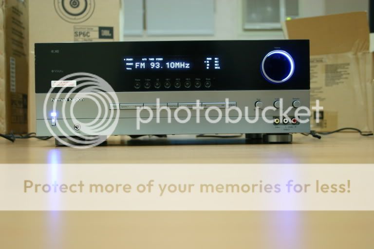

I have 3 questions I wasn't able to get the answer from the manual:
1) If I use the pre-out (to another amp), its a given that the speaker A and B binding posts will still work right?
[the HK's have this pre-out and main in jumper pins you have to remove to use an outboard amp]
2) does the HK have a subwoofer crossover setting? at what frequency? or does the sub out receive full range?
3) does this unit have an OSD?

1) If you use the pre-out without going back to the main in, the speaker output will not work. That is the purpose behind a pre-out/main in. It is designed to be looped through an eq, seperate amp ect.
2) The subwoofer output does not have a crossover to my knowledge. It is full range.
3) No.
This receiver is very versatile as a stereo unit. If you want all the bells and whistles of an Audio Video Receiver, you will be better off purchasing one (an AVR) instead.

can you explain 1) again?
I use a separate amp from the pre-out ... whats gonna go back to the "main-in"? source?
or do I put a wye on the pre-outs and stick it back in the main-in?

Any AVR in that range with pre-outs for all channels
OR, you can use a Y adaptor and still run to another amplifier as well as returning to the main in.

1) When using the pre-outs on an AVR the speakers (internal amplifier) still continues to work.
2) In a 5,6 or 7 channel stereo mode The front L/R still do L/R duties though some of their information is used in the center. The same would go fro a rear center. The center speaker uses a little information from the left and a little from the right.
The HK3380/3480 would work fine if you use a Y adapter on the pre-outs. One set will run to the separate amplifier and one set to the main in.
