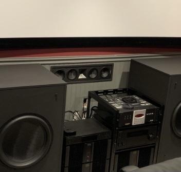

I had to laugh at this pic. My mind immediately saw the thread title...
“Trouble with dialog” hey guys, first list here...lmaO!!!!
Wow. Who is fine with giant subs that dominate a room, but decides to go with in-wall center that small?
At least my in-wall center is a full size in-wall tower that matches the LR speakers. Then, I can have the room dominating subs and still have good dialog. Yay.
