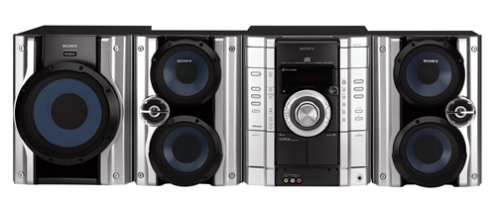

There was a time where majority of the market used to have HiFi systems such as Sony , Panasonic and Philips which didn't need any stands or anything.

The Sony system you have pictured and others of that same type are not HiFi systems. They are shelf systems. They are not of a quality that would make stand mounting them worth your while.
