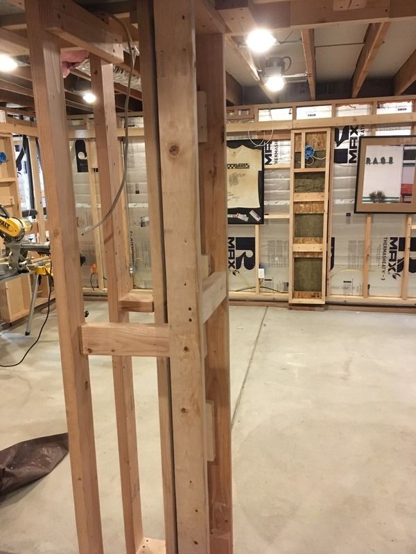

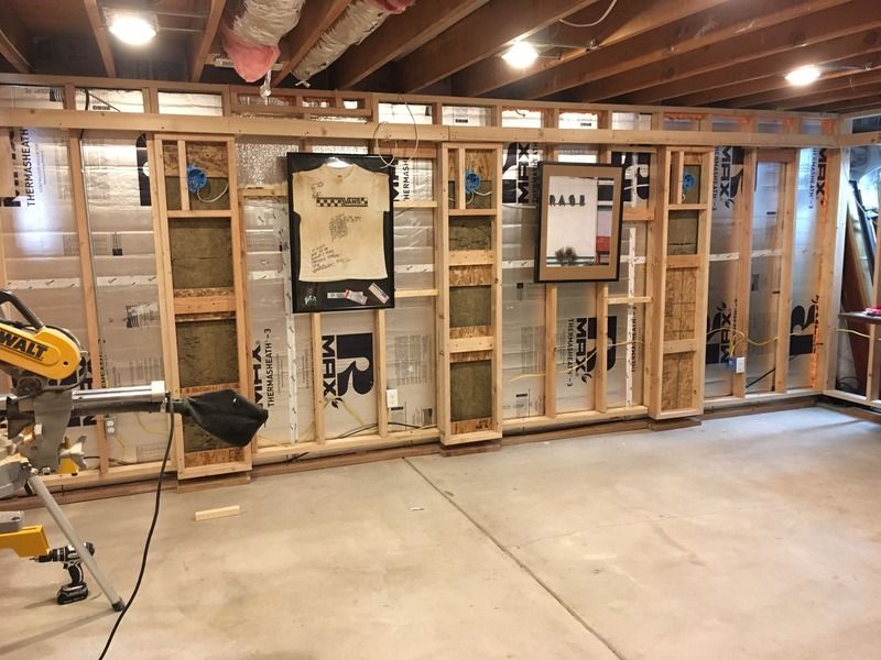

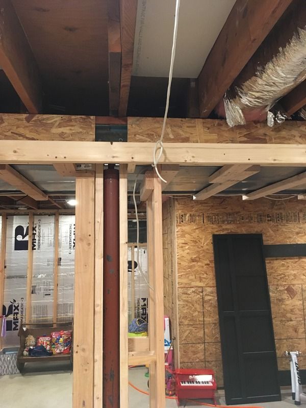

I think i'm pretty much stuck with my surrounds in the ceiling. I have one pillar that I plan to wrap in stone veneer. I could place a surround speaker on that. However, to set a speaker directly across from that it would be in an awkward spot in between my columns. I never intended to mount my speakers in my columns so they're not really big enough. What do you guys think. I'm okay with in-ceiling to get the best looking, but I'd rather buy regular surrounds. Everyone says the sound is better and then I don't have sound transfer to upper floor. I'm also thinking about SVS Prime speakers and I wouldn't know what speakers to get with them to match the sound if I go with in-ceiling. On the rear channels I can place them on the wall, but I think my surrounds need to be in the the ceiling. See attached photos. I don't have an east wall since it's an open basement design.
For a little background
I plan to build a stage up front, raised seating, running 7.1 and I haven't decided between SVS Prime or Aperion Intimus.
The expansion joint on the concrete is basically in the middle of the pillar. That's where a speaker would go on the wall across from it.
Pillar is to cover the lally column, not the best to work with
I'm doing a step ceiling for a rope light and theres not much room between the steps. I have an old house with pretty low ceilings so I'm doing my best with what I have to work with.
