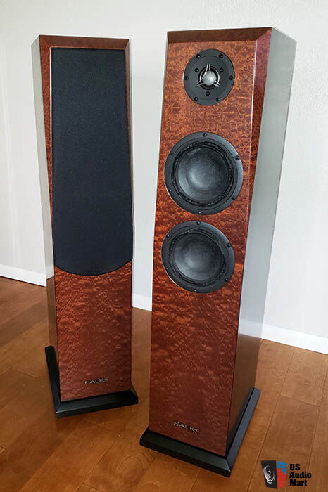

Just got the Veracity STs and paid more than the H2 TL asking price, though the finish is more less expensive. Wanna buy my ST's, they're a smaller foot print hint, hint, hint? Richard (@Swerd ) commented that the STs are about 90% of the H2TL, I'm guessing that 10% is SPL/Dynamics and both are transmit line cabinets FWIW. None of these need a subwoofer for anything but the lowest pipe organ note.
Good luck, always is fun getting new toys. I saw some has a pair of Salk built Philharmonic 3's for sale but that's a hefty footprint for most bedrooms.

You didn't include the Phil-3 that are available in MD. ;) Cabinets by Salk. Too deep for a bedroom though.
