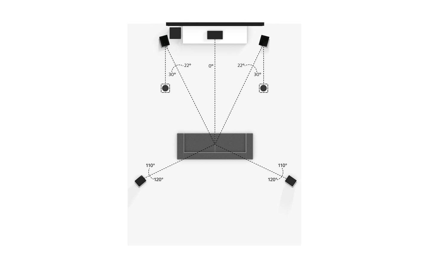

I am new to this site and have been scouring the forum pages for several days and have learned a lot. I am just starting the process of building a home theater area that is part of a large multi-use room. I have done a fair amount of research on speaker placement and have come up with my best stab at what my layout should look like, but I'm having difficulty with two specific speaker placements, the subwoofers and the main surrounds. I am attaching a drawing of my proposed layout.
Here are my restrictions and assumptions:
1. I am not looking for a serious dedicated theater room configuration and understand that my layout is not ideal
2. This is a basement room with 8' tall ceilings with the exception of some overhead furnace ducting. The walls are already framed in with 2x4's with concrete walls behind (1" space between).
3. No sheetrock yet
4. All speakers, including sub must be in wall or in ceiling. Yes, Yes, I know that this is not ideal, but the wife has dictated this, absolutely no visible speakers, (no under couch either)
5. I have already purchased my subwoofers - two Paradigm RVC-12SQ subs with a X-850 amplifier. I picked them up at a significant discount so I had to pull the trigger early. I do not have backer boxes.
6. I will use this area for watching movies, playing video games, and sports. The other side of the room is for ping pong, pool table, foosball, etc. Carpet flooring will be used on entire room.
7. I understand that the main surrounds should go in the wall at ear level, but I have a window on one side, and an open room on the other side. I am looking to use Monoprice Alpha Ceiling speakers that can angle towards the seating area. (monoprice 13687 dual 5.35" surround vari-angled)
8. I used up most of my budget on the subwoofers so I am looking to use monoprice for most of my surrounds.
9. I can't place a subwoofer in the corner as there are plumbing pipes there.
10. I know that subwoofer placement should be done through trial and error or testing, but that is not an option. I just need to try my best up front and i'll live with it. Its not a dedicated theater.
11. I haven't shown the center channel speaker on my diagram but i will install one below the tv (in wall)
12. I am trying to keep my theater area about 20' wide. I could possibly go a little wider, but I don't see the need as my seating area would probably be much smaller.
Here are my questions:
1. Which sub placement might work best? I have color coded a few options I came up with. Option 1 would have to go 1 stud bay inside each L/R speaker. Option 2 would be to put the subs in the corners, which I have heard is best, but they would be facing sideways from the viewing area. Option 3 would be to move the one sub over to the small corner if it would reflect better. However it would be further outside the listening area. Other options to consider? No, I do not want to sell my subs and build an infinite baffle and No, I cannot use a traditional sub, haha.
2. Am I ok to do my main surrounds in the ceiling as shown? I just don't know what else to do. I considered doing atmos speakers, but with putting the main surrounds in the ceiling it seems to kill that option. I have also considered using a nicer speaker such as a factory refurbished Definitive Technology UIW RCS III for the main surrounds (factory refurbished helps with budget constraints). According to the calculators I have used, the main surrounds should be about 14'-5" from the screen, but my overhead ducting requires me to move them a little closer.
Any help would be very much appreciated. Thanks!

The first issue is that you need the back boxes. That is not optional as stated by Paradigm. That is a tuned ported system and will NOT work without the back boxes which Paradigm state are required. Not only will the subs not work without the back boxes, but if you drive those subs without them, you will quickly destroy them from over excursion, and void the warranty. It is quite an ingenious design. I have to stress that the back boxes are NOT optional, but absolutely essential for that design to work.
The next issue, I don't see how you avoid is that the set up is across the short axis of the room and not the long axis, and I don't see how you avoid that.

Do 5.1.2 dolby atmos. The surrounds will be wider than those proposed locations. Approximately 110-120 degrees from center.
Read through these and you will understand why under no circumstances any 5 or 7.x layer speakers comes near the celing.
Take note of this. Do not allow your wife under any circumstances to force you into doing something that will kill the home theater potential.
Eppie
Eppie
I would place the subs below your mains (option 1) to keep the installation simple. If you need to cross them higher to match your mains you will have less worries about localization. Maybe option 3, but keep in mind what location will be less likely to be blocked by furniture or other items.
That open area to the games room limits what you can do. While the left surround could go below the window, you have no proper place for the right. I have used in-ceiling surrounds in the past and it is not ideal but better than no surrounds in my view (some will argue not to use surrounds at all in your situation and just go 3.1). If you have to go in-ceiling on the right, then you need symmetrical placement on the left. You are correct in that if you go with in-ceiling surrounds, forget about ATMOS. For a proper ATMOS setup you need to have the bed layer at ear level. Having the surrounds that angle to the listening position will help.
The other option I see is moving the TV to the short wall. Is there enough room next to the window? If this is a basement and the window is high, you should have room to install the main left speaker below the window. That would allow you to install the L+R surrounds in-wall at ear level (slightly behind the main listening position). You could skip the rear speakers. With a proper 5.2 layout, you could then add 4 ATMOS speakers in-ceiling for 5.2.4.

Great comments and feedback Eppie. Thank you. I also considered turning the viewing area to the other wall. My windows are quite large and are probably only about 3 feet up from the floor, but i could possibly put the left main speaker a little wide on the other side of the window in the corner. If i center the tv on the wall it overlaps the window as well, so i would have to shift the tv right. My other concern with that direction is if I end up with a larger sectional couch at some point it wouldn't fit as well. It would definitely solve my surround speaker issue though.

Are you interested in learning how to setup your speakers correctly op?
Your proposal is unsuitable for 7.1 but rather 5.1.2 with two ceiling speakers is appropriate with a change or two.
So far there's been no attempt whatsoever. Even the above comment has the front speakers way too narrow for their viewing distance.

Yes I am a beginner to this stuff and am open to learning more. I would love to hear your advice. My spacing I used was based on the modeler found on the audio advice website. The only thing different is the in ceiling surrounds of course...

Something like this? With the rear speakers being in the back wall?
That is the ideal, but as is more common than not you don't have the ideal, so you have to make the best of it.
I would definitely put the front three on the short wall to the right of the window.
The issue that concerns me is that it is a huge space with a lot of bass leakage. To provide a home theater experience is going to require a lot of power.
With your wife's constraints that is a huge problem.
I am far from certain that there is any commercial in wall subs that will do that room justice.
Having said that the really crucial speakers are the front left, right and center.
I would recommend these as the left and right speakers.
I would use this as the center.
I would enclose the 2 X 4 space above and below the speakers and fill the space with Polyfill. Otherwise the sound will bleed all over the house.
That gets your front three out of the way.
I would not go beyond a 5.2 system. You have no other option than ceiling speakers for surrounds.
Because of budget, you will need a receiver, and the system will be underpowered at first for that space. Make sure that the receiver has pre outs so you can add a powerful three channel power amp as funds permit.
With that space and your wife's constraints, I think that is the best you can do, which actually I think will be very good. My biggest concern is those subs. I doubt they will do the job required, but I can't say they won't.

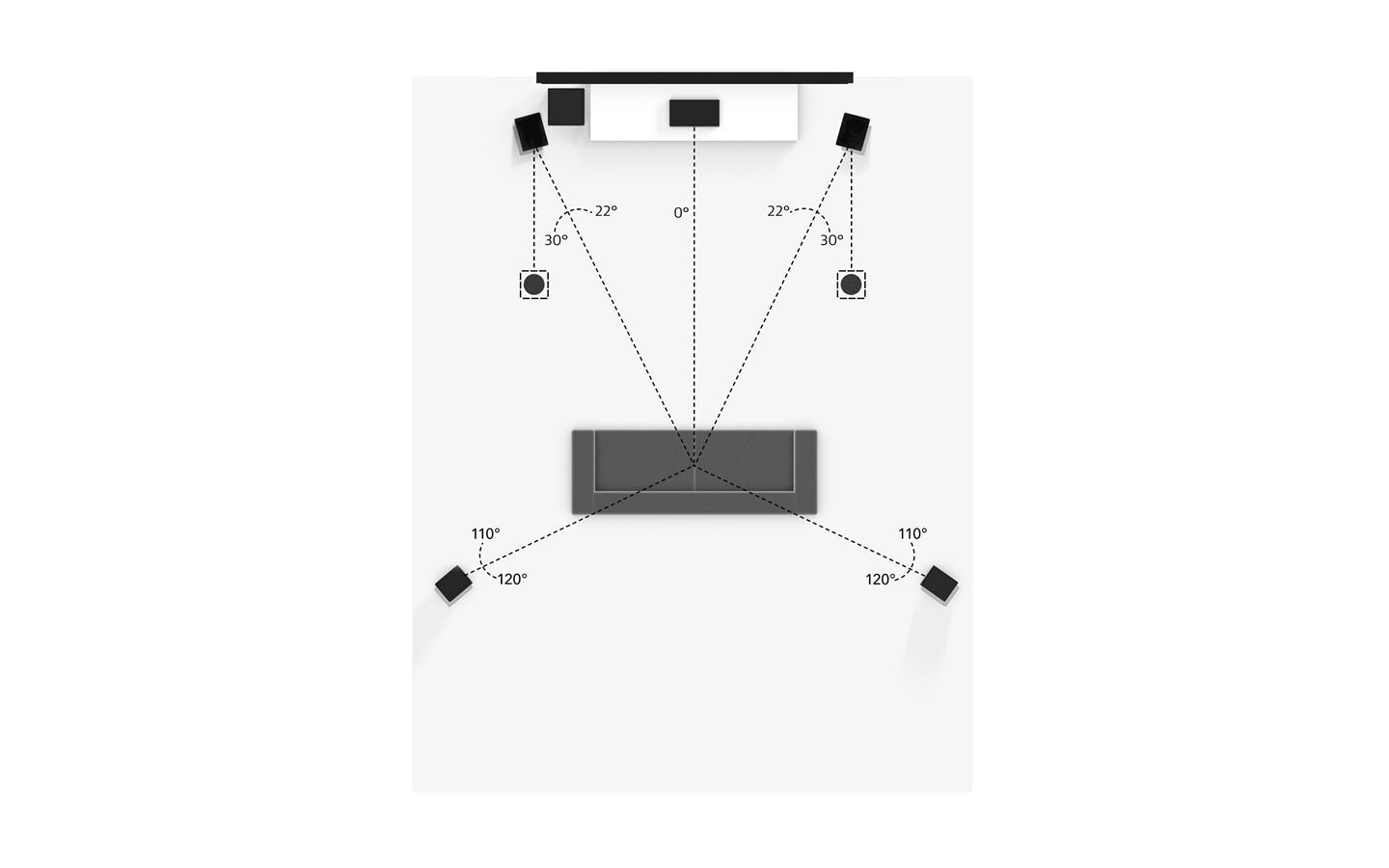

Is this any better than my first take? I followed dolbys diagram that I posted previously. This should make a 5.2.2 system. I could possibly make this a 5.2.4 but the rear atmos would have to be mounted about a foot lower than the front atmos due to my ductwork. Would that still work or do all the atmos speakers need to be at the same height? Also, whether it is a good decision or not, I think I've decided to not rotate the room and use the short wall. That window will restrict my ability to ever switch out my tv for a projector if I ever decided to go that route.
