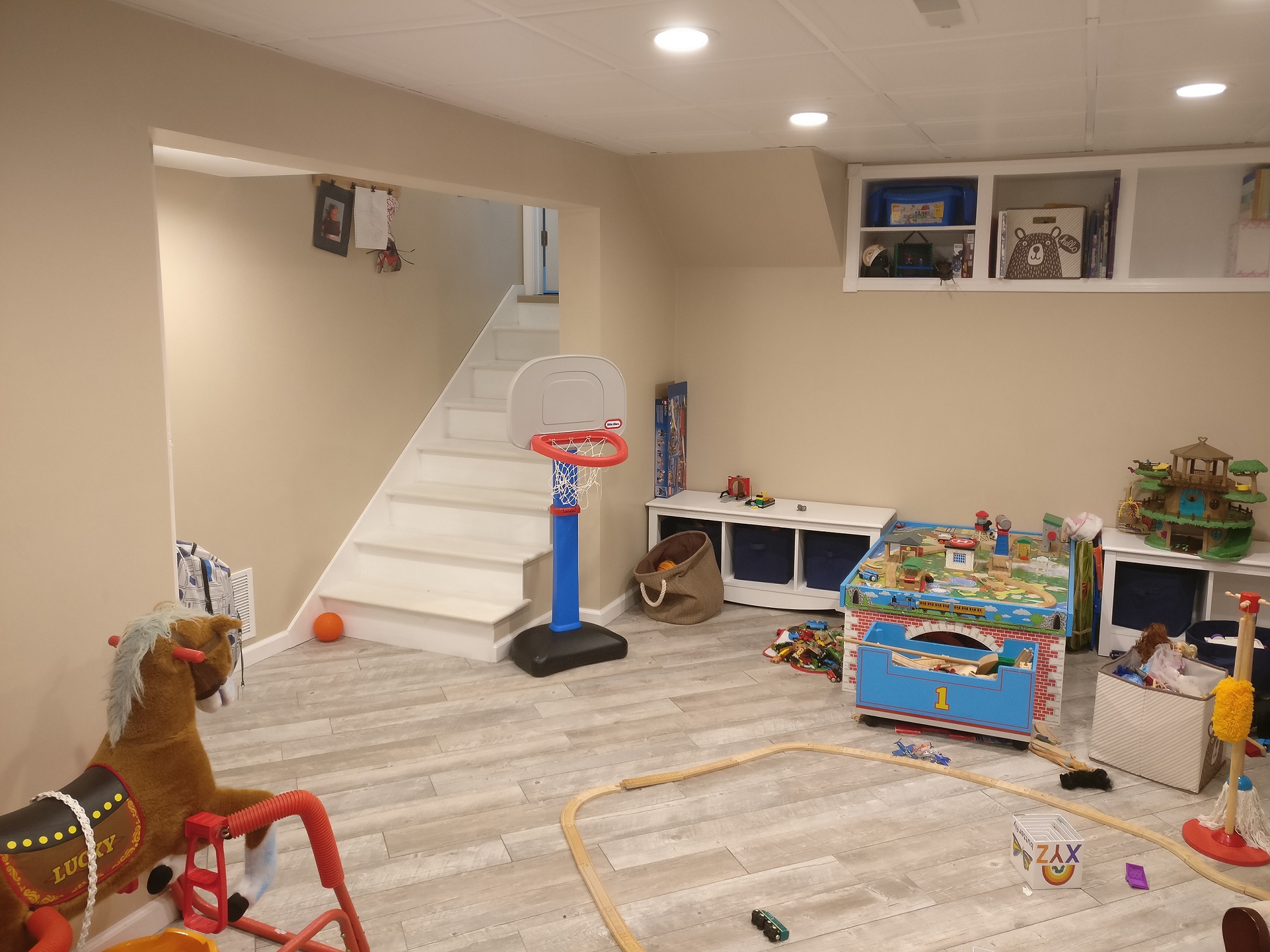

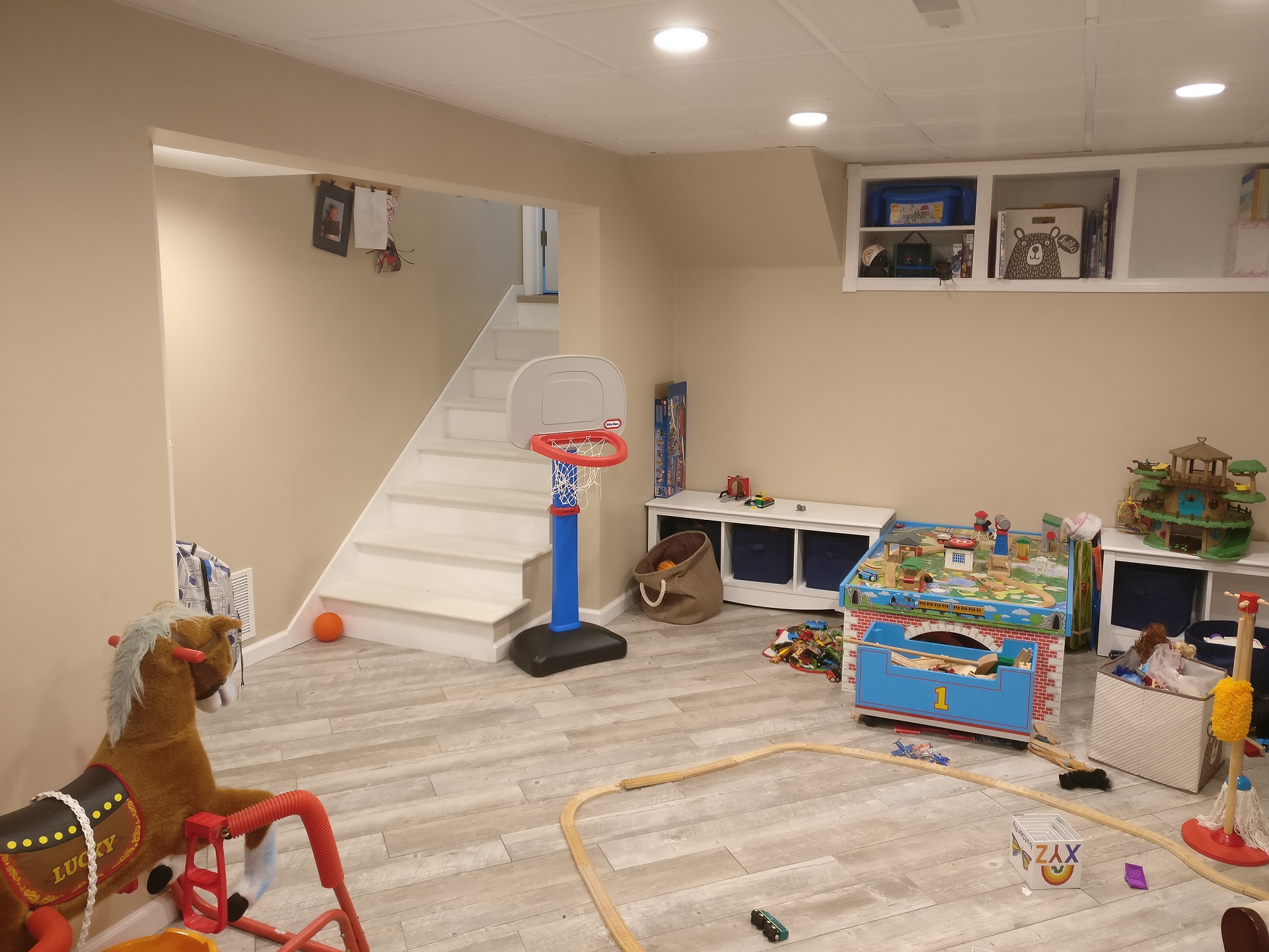

We are certainly a TV/movie household. Putting up a true false wall on either end of the room will be a sell on the WAF front. She loves the sliding barn door on the one end and the built in shelves on the other end. That's what led me to the idea of being able to slide the TV out.
I certainly want a minimum 75" TV. I haven't decided on something like an 85" LED or 77" OLED. Here are a couple of pics (please excuse the toy mess):
Two things stick out at first glance:
  1. the drop ceiling is going to make cable runs much easier. :)
  2. the tiled floor (I'm assuming thats a laminate, but if it is real wood...good for you it looks great) and clean walls will be issues for reflectivity, but the rug will help.
I agree that it may be best to flip your plan to the other way direction.
All in all, you are well on your way to a very nice room!
B
bigkrazy155
Thanks! It's a wood look porcelain tile. I definitely foresee the acoustics to be well on the lively side and will have to come up with some treatments at some point. I guess I'll have to come up with a quick and dirty plan when auditioning the speakers. But dang...I really don't want to have to flip the room! The drop ceiling makes wires easy to run, but those built in shelves and the stairs along that wall make it tough to get into. Plus I'm not sure I can center a wall mounted TV on that will with the bottom of the steps.
