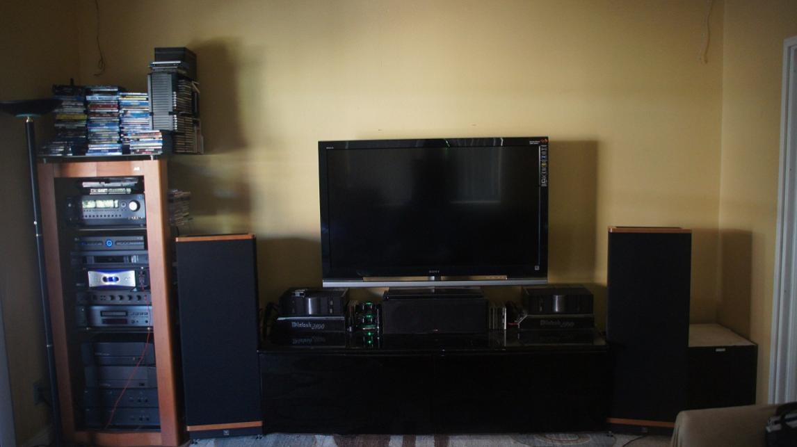

This is what I have and what I'm dealing with, as you can see I can not move my speaker any further. I spoke to the guy from Seymour Screen, he said the 4K may not work properly because the room need to be very dark or have a high lumens projector, mine says ANSI Lumens 900 as you can see the spec above. So, anymore screen recommendation.
1. Move your gear, move your speakers further out. You certainly have no reason to have a huge audio tower in there, and you could easily put it in a credenza under the screen.
2. Front projection is something of a commitment. Some time spent working on the room can drastically improve the quality of the final result. In a completely dark room (dark paint, dark ceiling, dark carpet, night viewing) your end result is better than your typical movie theater.
3. If you OWN this home, then why not set the room up the way it should be?
4. If you just want to give this a try, then get a cheap manual screen to try it. Check eBay or Craigslist for a screen and try things out... or make something yourself. Paint a piece of MDF (or similar) white and try it out.
If this were my space, I would put all the equipment either in a console under the screen, or I would remove it completely from the front of the room. Spread the speakers out to the corners and move the sub about 1/3 in from the end of the wall. I would paint the room a dark color (blue, red, green, grey, etc.) as well as the ceiling. At some point I would go with dark carpet to match. Get some really good light blocking curtains for the windows to allow me to close them and use the projector during the daytime if I wanted. Then, I would hang the TV on the wall and go with a 110" diagonal DaLite tab tensioned screen with high contrast cinema vision material and mount it so it would drop down in front of the TV on the wall.
If you don't own the home, then a cheap manual screen on L brackets in front of the TV would be about as far as I would go.
I've been doing front projection for about 15 years now, and I've pretty much done everything I just listed above, and I've had my room setup like yours before. It's a night and day difference setting things up properly.

Let's say your speakers are 10" deep or so. You say 1.5' from these to back wall. That means an AT screen in front is already at least about 2.5' from the back wall. Accounting for thickness of your noggin, let's pretend your eyeballs are 2' from back wall. (Further would likely be better for audio, btw.)
You never specified which wall was 13' (or did I miss it), but let's pretend that's length. 13 - 2.5 - 2 = 8.5' only. This means that even a very modest screen of 76" (16:9) will give you a 36 deg viewing angle. After much playing around, I prefer 42, and wouldn't change a thing myself, and if you were like me that would still be relatively modest at 90". I think poster above might be around 45 deg or so.
But let's say you get further away from the back wall to improve your audio situation. All of a sudden, the screen needs to be smaller and smaller. Anyway, I think you get my point; your need for lumens might not be as bad as it sometimes is with others who are looking for considerably larger screens.

I don't think you got as hosed as BMX might think you did, I think it might be a decent projector for that money, assuming it's been well cared for, with relatively low hours (which you probably don't know, lamp timer probably gets reset each time, and I agree that you are extremely unrealistic about lamp hours). It was a direct competitor to my own projector, the RS1, not quite as bright, but probably a little quiter as a result. I don't think you would call it a screaming deal either, but there might be value here IMO. Though if you had more play money, of course I'd vote for new as well, but you have to pay to play. Seeing McIntosh gear up front, I'm thinking you could probably have swung a new one if you wanted too, but whatever. Also, it's not quite 7 years old either. It was introduced at CEDIA in the fall of 2007, which means consumers in the US weren't really picking them up in earnest until 2008, which is only 4 years ago. Sort of.
Darken the room some, I think you'll be ok. Chris Seymour said "may" for a reason, but you could say that about any darn screen.
Definitely get anything with a light on it away from the front. The alternative to moving the rack would be to instead switch the couch over to the front wall, making it the new back wall, with the rack on your side. Hey the HDMI run will be shorter if the PJ is close to the rack I suppose. EVEN THEN, I highly recommend doing the following: putting each component display to minimum brightness, liberal use of window tint on these displays just don't cover IR sensors, and even the use of black tape if need be. You know, just one little tiny uncontrolled light source like a night light, candle, whatever, so dramatically decreases the PQ level, it's like the difference between a $2,000 projector, and $10,000 projector. In the case of the projector world, the room truly is the end all be all, in a way.
If you do go with a solid screen, the Carada that BMX suggests happens to be Seymour's preferred solid screen for the money, FWIW, and that says something.
Well- do you need a different screen than (insert any brand here) due to the lumens? It sure is possible, but that depends on your light control inside the room, and the size of the screen. They are equally important for your intents and purposes.
