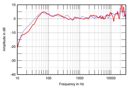

The bass tuning is far too low and one of these very poor sounding so called extended bass alignments.
You can see the dip of the saddle between the tuning peaks is around 20 Hz. No drivers of the size in those speakers is going to have an Fs anywhere near that frequency.
The result: -

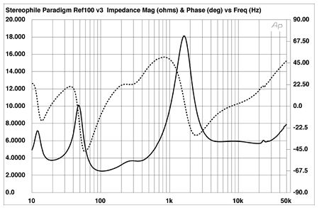

There is a rising response below 300 Hz, peaking at 60 Hz. However you know this will sound even worse than it looks, as it has to be a speaker with high Qts. Speakers like this have very poor bass quality, and these did.
In addition this tuning has resulted in a very poor impedance curve and phase angles. So yes, it could embarrass some amps.

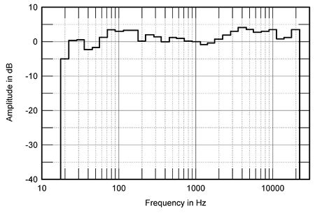

Looking at the frequency response there is indeed a rise in the 2 to 5 kHz range. This is a very bad place to have even a small rise. The response above 7 kHz is just awful and ragged. The tweeter on those speakers is just bad pure and simple.

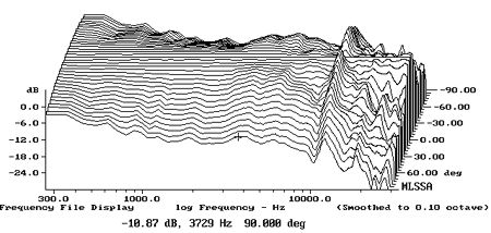

However it is worse then it looks. The lateral response is less than stellar.
This results in this spatially averaged response: -
You can see their is a whopping 5 db rise in the 4 to 5 kHz sibilance band.
So that is why your speakers are sibilant and why they fizzed at me.

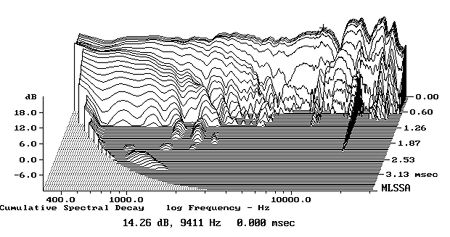

This all adds up to a less then satisfactory spectral decay plot: -
So Audyssey was correct in shelving the HF. However it will not cure the situation, as the tweeter is in break up mode well in the audio band, so there will be a lot of retained energy and unsatisfactory HF performance.
