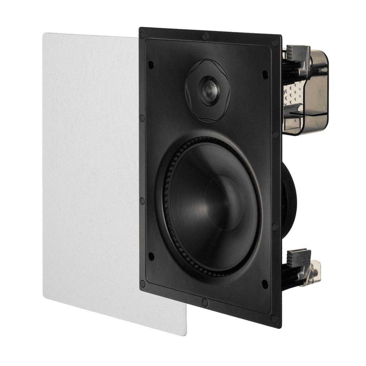

The Elite CI-E80IW
Considering these

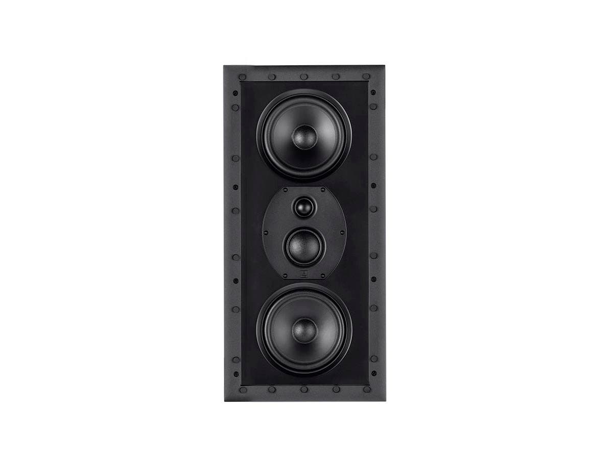

Monoprice THX-365IW
My head will be 13 feet back in the bed.
Would like good dynamics and low volume performance at 13 feet distance combined with a sub will the Paradigm be sufficient or should I spring for the Monoprice

As for speakers, I think it is almost a wash. The Monoprice speakers are very nice, but you aren't coming from bad speakers to really nice speakers, you would be going from really nice speakers, to other really nice speakers which are just different. As long as the sound bleeding out of the back of these speakers isn't bugging the rest of the house all the time, then I would stick with the Paradigms. I think a actual change would be to a speaker with a decent back box, like a Triad in-wall speaker. Still, I would be hard pressed to go that route unless I was really unhappy with the sound of the Paradigms.

And I do like the paradigms so I'll save money and use that towards a good sub.
