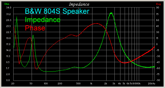

I must had delusions or something - I tried to find back the post that stated 15kHz and I can't find it. :confused:
I also compared the graphs 500 and 1000asp graphs a little more closely; B&O don't show a 1dB drop at 20kHz but it's getting there and under an open load the drop off starts at about 3kHz getting down by 0.1dB by about 5kHz.
The impedance of the 804S which are the target speakers looks like this;
It drops to <8ohms at around 7kHz but never gets below 5.7ohms in the upper frequencies.
So the question is, will the 804S's relatively high impedance at these higher frequencies help to keep the freq response of the 1000ASP more linear or will the drop from 31ohms at 2.5kHz to about 5.7ohms at 20kHz exacerbate this non-linearity in the amp?
