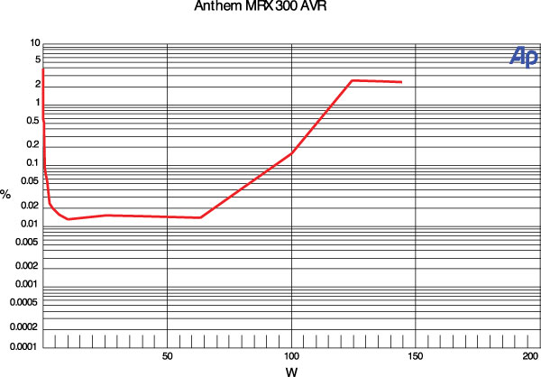

Yes, focals 926 are rated with minimum 2.9ohm impedance, but with high sensitivity and rated nominal 8 ohm - I would guestimate that manufacturer is not far off truth. I have not been able to found independent measurements for the speakers.
That said I did find them for MRX 300 - http://www.soundandvision.com/content/anthem-mrx-300-av-receiver-ht-labs-measures
Which shows that 60wpc/5ch is quite underrated. I doubt many could notice even 1% distortion.
What I'm trying to say OP needs MARGINAL POSSIBLE improvement in amps section, maybe XPA-200. Anything over it = overkill
Unless the impedance and phase angle traces are available, I would not put much stock in that 8 ohms nominal.
A high-phase angle at even a 4 ohm impedance will limit the power below its 4 ohm rating.
Focals are revealing and those distortion levels not that low. I also don't like the way it climbs the wall at the low end. That does not look good for those who believe the first watt should be squeaky clean.
Power into load may mater more than the absolute watts available but it correlates well with powerful amps.
