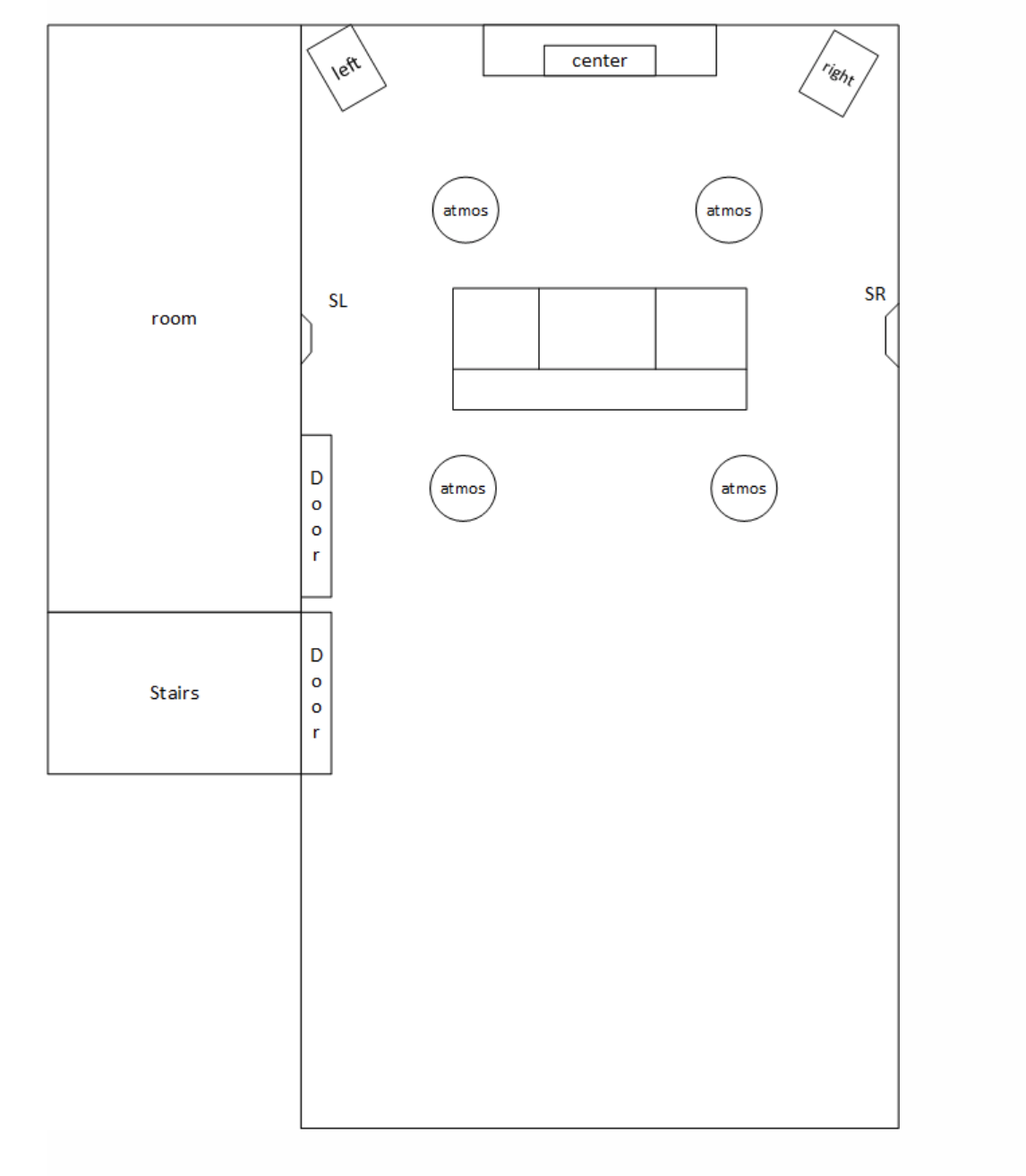

In my current home. I have a 5.1 setup, all Paradigm. My surround are 100-110 degrees, 7 feet away from the couch on each sides.
Now I'm moving to a new house and I'll install my HT in the basement. It's 11.5 wide and 23 feet long.
Here's a not accurate MS-PAINT plan of what I would have love.
As you can see, I can't place my surround as before because they will block the door on the left.
I can't use the other side of the room for several reasons I won't explain here.
A idea I had was to remove my current monopole surround and replace them with wall-mounted bipoles like this.
In the future, I could add back surround directly behind the couch (so it will not block the door)

Why don't you just mount your monopoles where you would place the bipoles? There are some sturdy wall mount brackets out there that can hold bookshelf speakers.
Dentifrice
Since the room is narrow, I fear it will be difficult to move around with a 3 seats couch and wall mounted bookshelves.

1- Having bookshelves on stand on each side of the couch will take too much space and it will be difficult to move around
2- bookshelves will be few feet away from our ears and might sound too "direct" ?
That's why I was looking for bipole or at least small footprint speakers (like KEF T101). In those case, I'll be able to mount them on the wall
1. With surrounds you want directivity. You can use DiPole but most will agree a regular speaker is preferred. In addition, bookshelves are easy to move into place where ever you want.
2. When Audyssey sets up the speaker volume it's based on where you set the Mic. So no matter where you place the speaker its volume will be set to match the other speakers. A speaker closer than the others doesn't matter with Audyssey.
What I'm trying to say is your decision making so far seems to be based on incorrect assumptions. Once you realize Audyssey does the level matching and a bookshelf on a stand is easily moved, it's a different set of options.
If the room is going to be semi dedicated you could possibly use IW. That would help to widen it.

I wouldn’t necessarily say his assumptions are incorrect. Audyssey might level match, but hot spotting is a thing and can be quite annoying. Just the opposite of involving.
