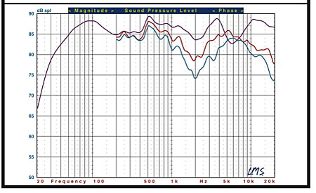

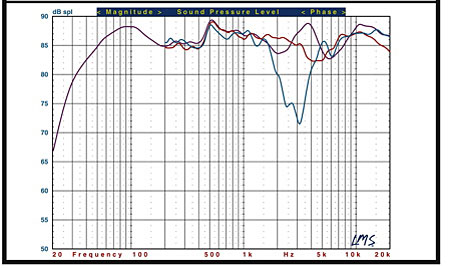

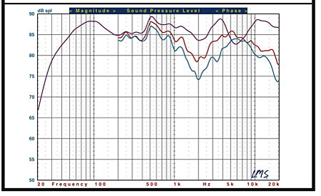

B&W 683 - https://www.soundandvision.com/content/bw-683-surround-speaker-system-measurements
The reviewer noted:
The vertical responses shown in Fig. 2 strongly suggest that you avoid listening positions significantly below tweeter height.
Fig. 1: B&W 683, pseudo-anechoic response, off-center in the horizontal plane, at 45° (red) and 60° (blue).
Read more at https://www.soundandvision.com/content/bw-683-surround-speaker-system-measurements#k0RdKiD1fUD7EbL2.99
Fig. 2 : B&W 683, pseudo-anechoic response at 15° above (red) and 15° below (blue) the tweeter axis.

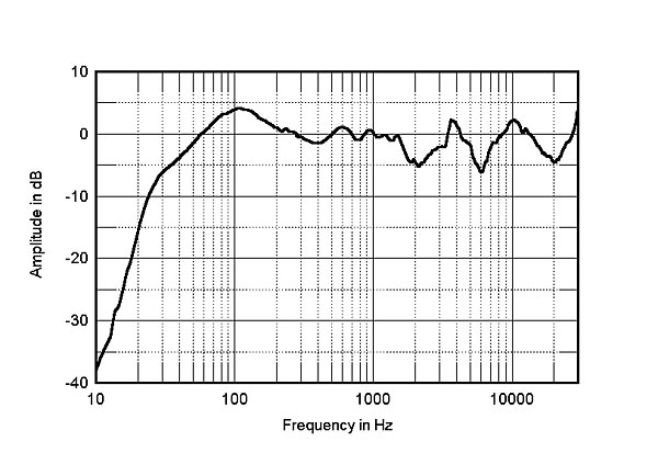

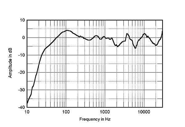

B&W 683 S2 - https://www.stereophile.com/content/bowers-wilkins-683-s2-loudspeaker-measurements
The reviewer
