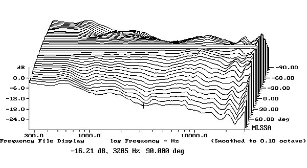

Now I know your speakers, I'm going to recommend you have an audiogram done. You may have a hearing problem. I have one rig that has no center and the one I'm using now I listen to two channel unless there is a center channel. I do not have trouble with speech and nor does my wife.
I have auditioned those speakers and would not regard them as retiring.
They also measure very well. They so have a slight sag in the horizontal dispersion response at the upper end of the speech discrimination band.
I would recommend the speakers not be toed in or out and listened to on axis.

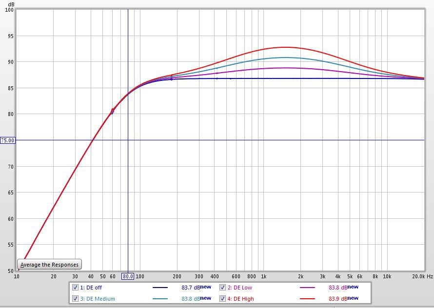

Here is what I got from the Denon forum if you are curious.
The dialog enhancer has three positions: low, medium, and high with the following frequency enhancement curves.
Does it make sense?
